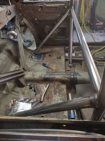

Well, I didn't do what I said I was going to do. I worked on my cage for a couple hours.
I noticed something when I welded the US cartool leaf spring relocation mounts, I was burning through the floorboards in a few areas so I thought "well that's a weak link" so I welded some 6×6 steel plates inside on those 2 areas and connect my roll cage to the plates, it should add a good amount of strength in that area.
