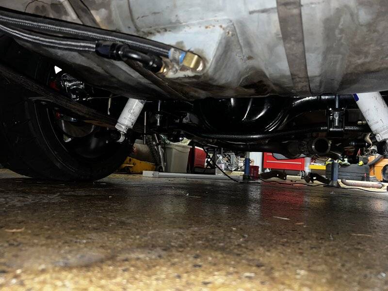

Finished the 9” rear end install with disc brakes. The 1” longer yoke did allow me to use the same driveshaft from my 8 3/4 so I was glad that worked out! Also installed sway bars front and rear.

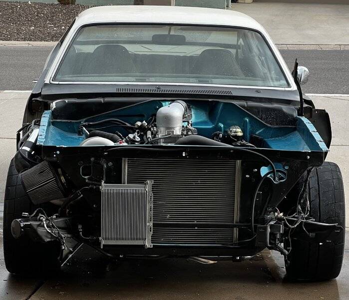

Pulled the front end off so that I could make a little change. Finally “cooling” off here in Phoenix so I hope to be back on the road soon.

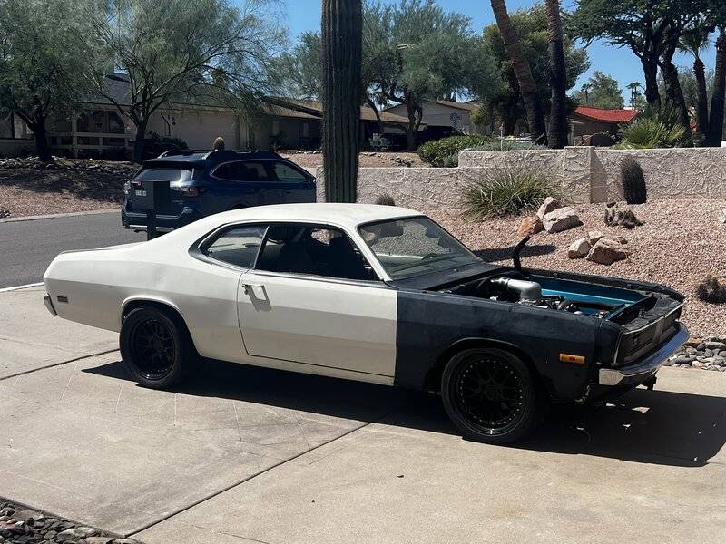

Picked up two dodge darts from Oregon over the summer. The black one is just a roller pieced together from ‘70-‘74 cars. The grey is a 318 swinger that runs and moves, but needs plenty of work. The black front end is going on my duster. With an extra 6+ inches in front of the radiator I’ll likely be installing an air/water heat exchanger…eventually.
Not sure what’s happening with the grey car yet. My 14yo son has to decide if he wants that, or the orange /6 ‘71 duster I bought for $100 in 2003. I’d love to turbo that slant, but the decision is his!
I had to modify the exhaust crossover so the front sway bar would fit. Once that was done I fired the motor for the first time since installing the new valve springs. I let it warm up and gave it a couple free revs. It hit the 6500 limiter so I’m hopeful that my rev issue is solved, but time will tell. I also removed the external oiling to my heads as it was planned before I knew pushrod oiling would be an option. It appears that was my low pressure issue. With oil temp at 190 I still had 30psi at idle.

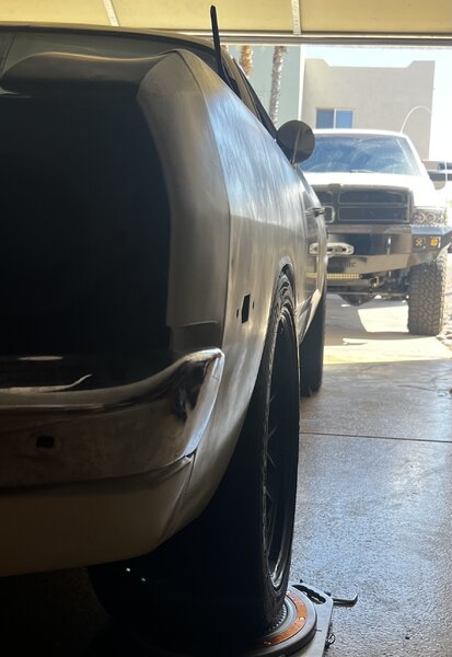

It seems dart fenders are slightly tighter than the duster’s. Wheel fitment is incredibly flush. I’ve found zero rub even on the bump stops, but I’ll probably roll the fenders for good measure. The car should be back on the road next week.

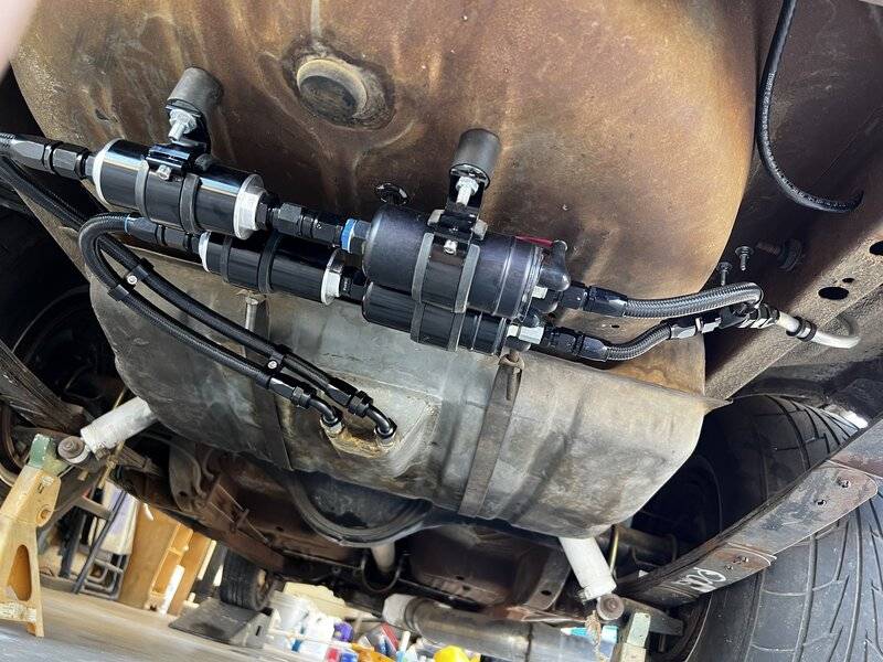

looks like it’s time to wire up my second fuel pump. I’m using a knockoff aem 400
Ok wow, 17psi of boost?! That must be boiling the tires. What injectors are these, still the uncapped Fords?
How’s fuel pressure look? How are you getting E50, mixing your own? I run basically the same pump setup. You should have plenty of headroom with both wired up. I kick my 2nd one on at >70% TPS.
Still the uncapped fords. Not sure what fuel pressure was. I have a gauge, but it’s not been very reliable. I may have one more input available to log pressure. Looking into that now. I didn’t realize you were turning on a second pump, or that I would need one.
I have found the flex fuel function to be great with the microsquirt. I’ve run anywhere from straight 91oct to e85, and AFR stays right where it should. I do aim to mix right around 50% so fuel demand stays a little lower.

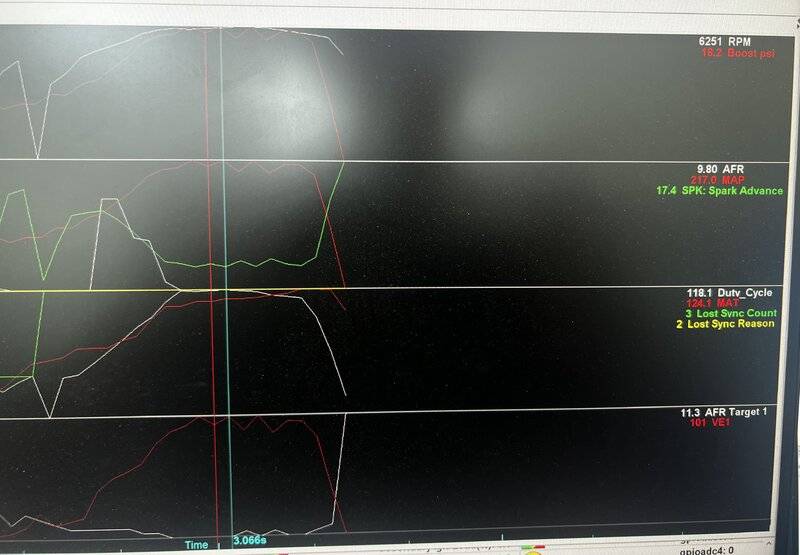

I have some re-tuning to do, but the second fuel pump did the trick. I don’t think AFR reads below 9.8, and it was definitely drowning in fuel this run.
Traction has been great(above 70)! Lol

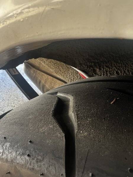

Some decent feathering on the tires which have maybe 200 miles on them. Knowing little about tires…is this okay? Lowered tire pressure from 22 to 18psi after this picture. I have a MT ET street R setup sitting in my summit basket. Just waiting on the right beer to press the button. I still think I should prioritize a nice set of injectors…
