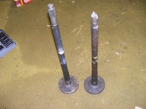

Depends on how BIG your gonna go?The 8 1/4 can only handle so much HP.Ask me how I know! Picture 010.jpgLaunching 452hp with a 4 speed!
