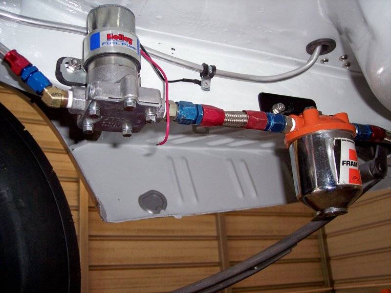

This is how I did my fuel system 68 Barracuda.

Top side how I plumbed it.
A couple questions.
Why the regulator just out of the tank?
Why drill through the frame, why not just run them on the inside frame rail up to the front?
Why run the line up the inner wheel well? I thought that was dangerous (debris/tire failure)
Definitely not knocking any of your work, you’ve done amazing work for sure.
Just wondering thoughts behind your process.
Thanks for the pics!
Wally.
A couple questions.
Wally.
1- The regulator is on the return line before the tank
2- If I grenade a trans, I'd rather have the line on the outside.
3- Ran braided line up the inner fender and it is shielded.
Is there an advantage to having the regulator on the return line?
I always thought you wanted it regulated just before the carb?
Understood on the trans exploding, and understand now going up the inner wheel well.
Nice work, definitely gave me some ideas, I really appreciate the replies!

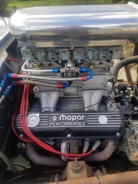

No it doesn't matter where you mount the regulator in the system. As long as your using the right regulator. This is the one in the picture.
Holley 12-803BP Carbureted Bypass Fuel Pressure Regulator
Remember being at a car show and someone talking about running the regulator on the backside of the carburetor? As in an Edelbrock and tapping an exit hole on the opposite side of where the fuel enters. Running the regulator on the backside of that so that there is a constant cool fuel running through there? Sounded doable..
That is how I have mine.......Tank , filter , pump at the rear of the tank. -8 to carb with regulator past the end of the carb , and gauge and return plumbed off of the regulator. The return line runs out of the bottom of the regulator , the gauge off of the front port.
Not a great pic , but you can see the regulator hiding behind the accumulator.
I modified mine to run as a bypass regulator, that way I'm always moving fuel.
Although after talking to so.e guys with realy fast cars they said they didn't see and change in ET when going from dead head to by pass.

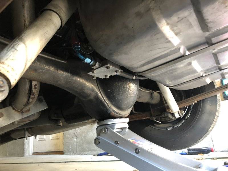

Here's how I did mine. Never done it before. Not perfect but it supplies the fuel to where it needs to go.
Really nice work!!
