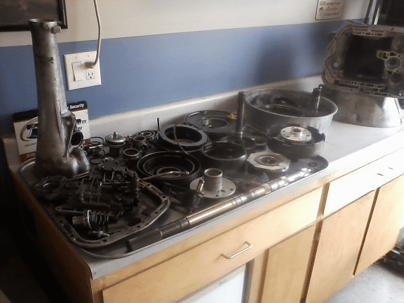

I tore the 727 apart last week, but had a chance to take apart the sub-assemblies today - clutch drums and whatnot. Everything looked good. Saw a couple parts that need to be addressed, but nothing crazy. Pretty clean for a 52 yr old part.
Maybe he'll just examine every wear surface. Posting that pile of parts that we've all seen before just gave me the impression that he was going to make assumptions about worn areas of hard parts.
