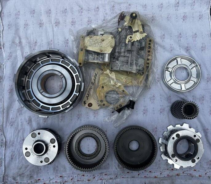

So the parts arrived months ago, but there was no time to get things done. I also got rollerized rear support, but never took a photo. Here are some pictures of the goodies. I used kolene steels and alto frictions. I had plenty of these. Also rigid wide front band, billet steel anchor and strut etc. Next purchase is 300m input shaft but this will need to wait. I regret not buying it now. Pulling transmission from my car is a total nightmare. Took me over 4 hours.
