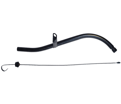

I've never seen a filter imprint on anything in my life with a stock pan and I've done transmission services since I was ten years old. I am 53 now. Also, the service manual ain't always right. The information I am sharing here is from my personal experience. I cannot ever remember putting 6 quarts in a 904 or 727 that had a stock pan just on a drain and fill/filter replace. The best thing to do is to trust the dipstick. If it tells you to put six quarts in, then do it. Do whatever the dipstick reads. Pretty simple, really.

, I dont have a stock pan its a deep dish extra capicaty pan that i have on it.i have a six in now,its still alittle low.

It does not matter if the pan is eight feet deep. The dipstick's full mark will still be correct.
