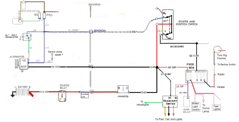

There is one that feeds power to the rotor (blue wire) and one that connects the rotor to the regulator (green wire). Both of them go through an extra connector near the back of the engine. make sure they are connected and in good shape.
Check the alternator output wire. Its connects to the 'Batt' terminal on the alternator and also goes through the engine connector. Do not let this one touch any metal. It is connected to the battery positive at all times. if you need to work with it, disconnect the battery..

The reason I wrote that is with '73 is that the fusebox is not illustrated the same way it was in the earlier books. We have to go back and forth betwqeen pages to figure out the circuits.
There is a 12 gage red wire with a white stripe that feeds that feeds the fuses that are always hot. Nothing to be gained by messing with that.
OK there is also X1, a red 16 gage wire coming from fuse 4. That's standard from the factory.
X1 goes to the cigar lighter and some options like map light.
But Fuse 4 also feeds M1 which includes the dome light. So if the dome light works, then that fuse is OK.

The open white circles and squares represent connectors. The 'engine connector' is a common location for problems to develop on the cars that have them.
Look around the right rear of the engine.

When the car is running normally the alternator produces power at 14 Volts more or less.
Current flows as shown by the orange arrows.
With the lights on current flow would look like this
When you turned the lights on, the ammeter went from less than 5 amps discharge to 15 amps discharge. So the engine was running on the battery and then the lights were also pulling from the battery.
This could be because the alternator or the regulator had an internal failure.
Or it could be the alternator output wire, or either of the field wires (blue and green) are disconnected.
