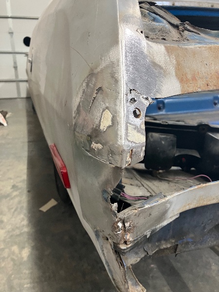

Hood scoop on painted! Good from a far but far from good. KrylonKustoms! Haha. Windshield on order and currently working on driver side taillight opening. Previous owner had a horrible fiberglass repair, I cut the corner out of the parts car so let some body work begin.
Rear panel repair is coming along nicely. Getting metal welded in and then some body filler and we’ll be good to go! Also got the windshield installed, local glass guy, not me and I’ve been driving it around! That single chamber exhaust is just too loud. I ordered different mufflers to try. Hopefully a little more manageable. Went to try a good brake test today and heard a big pop in the front, the right front strut bar popped out of the lower control arm. The bolt is missing along with most of the threads, so some QA1 adjustable bars are on order along with new steering components! A lot of people giving me thumbs up and people at gas stations coming to talk when they see it. A lot of, I had one of these high school and I love hearing old stories about old cars.

Just some more pics of the rear corner repair, still needs body filler but good enough for now. And working on hood scoop supports, or jail bars. Got 1 bar and like it, any opinions on 2 more for a total of 3?? I have chrome tubing that goes over the all thread, just didn’t want unbolt the scoop just yet.
