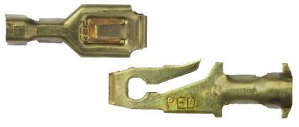

The "cocoon" you mentioned may or may not be foam There are little latches on the connector terminals you can release with a very small screwdriver.
An example of the female side showing the latch
Latch on male terminal
