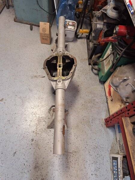

Well, I decided to save some money and build one myself, with help from a few friends. I got really good buy on this setup, I couldn't justify the price of new, especially factoring our currently weak Canadian dollar. As a bonus, the seller took a bunch of my 8.75 parts on trade, this greatly reduced the price.
1973 3/4 ton Dodge truck housing, factory 4.10. The tubes on this measure 3.123" in diameter.
Yukon Grizzly locker NOS
Moroso gold anodized rear cover
All brakes
Housing ends.
I have everything, a lot of it not pictured, except axles and axle bearings, which will be ordered from Dr. Diff. I borrowed an arbor, pucks for housing alignment during welding, and the case spreader. I'm looking forward to this build. Having fully rebuilt an 8.75 2 years ago, I am blown away at how much larger everything Dana is.
That rear cover is TITS!
Think about starting a new thread that covers the build step by step. I would definitely follow along. Good luck!
Thanks, I agree that cover is bad ***! I was lucky to find it, especially being NOS. Should look cool when viewed from behind under my Dart.

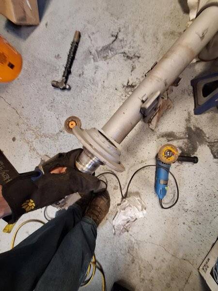

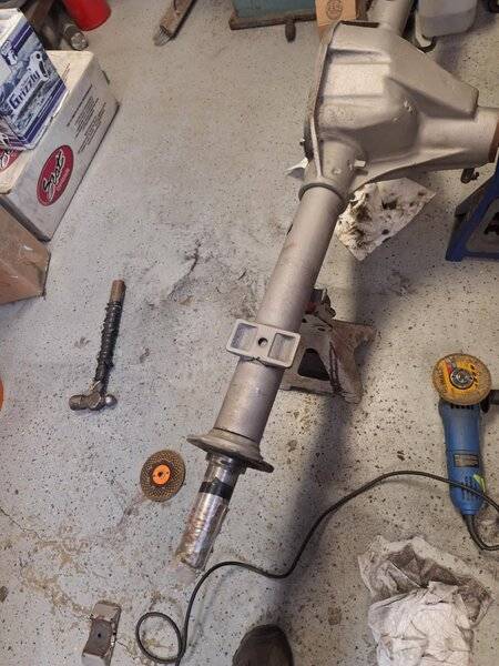

Some progress on the Dana 60 project today. My friend, Rod, cut the truck floating axle ends and spring perches off. The next step will be putting in a lathe and cutting to proper length with chamfer cut. We will also be turning the axle tubes down to save some weight, shooting for .250 tubes. After seeing the construction of a Dana 60 vs 8 3/4 it is apparent why they are so much stronger. More updates to come.
When you turn your tubes down are you putting the whole unit in the lathe or are you going to press the tubes outta the center section .
The whole unit. At least, that was our thought.
We are also considering welding the tubes into the center housing, around their circumference.
