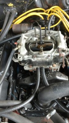

Carb has no choke cable??.. linkage just flops..going to take carb apart and see if anything's amiss..then figure out where to put the cable for choke and what's missing to hook up the choke cable???.. guess I should have started their .lol
I don't think I've ever seen a manual choke TQ. I guess some of the racing TQ''s might not be auto chokes. On a regular TQ, the fast idle, choke, choke-stat, choke pulloff, secondaries are all inter-related. I don't know how that would work with a manual choke.
Guess I'm missing piece on passenger side of carb..their is an adjuster but nothing leaning for it to touch?? 1534882154514890393560.jpg
ll]1715213510[/ATTACH]
several pieces. (electric?)choke thermostat is mia. there are two linkage pieces and spring and retaining screw missing from the end of the shaft where the orange cap is now. there's probably an idle stop solenoid missing at Rt frt corner of carb. On the plus side, the links that I can see are in the right place! I once bought a TQ carb at a swap meet, that had every one of the links in the wrong place and each one bent to rat-$hit to try to make them work.
There is no OE manual choke TQ.
Only the racing TQ’s have a manual choke.
Your missing the choke set up. It bolts into that “Y” shaped well on the passenger side. It has a rod that goes up and connects to the carb in conjunction with the pull off.
The “Adjuster” is where the solenoid goes to prevent run on by closing the butterflies when you shut the engine off.
Also noticed your EGR valve is not hooked up.
Their are no electronics on the carb.. always been like that from what I remember. I drove at least 25 k with setup like it is..must be messed up inside??
Hard to tell by your picture but Looks like it should be the one on drivers side that is capped, small to the out side of mixture screw. No vacuum at idle, vacuum will start as throttle is opened.
The vacuum for the butterfly is getting vacuum from Port on back of carb in lower middle..
Is your car set up to run full vacuum advance or ported advance? Sounds like part of your problem COULD be you should be running ported advance. If so, confirm forward is ported, if so connect and try that with the proper adjustments.
Nothing on distributor.. vacuum piece looks messed up on it tho...my dad was known for rigging Stuff.. everything looks ok inside distributor tho..I'm going to hook up other way and see what happens
Dash pot vacuum does go to the rear of carb so would leave that there. Sounds like you need a vacuum advance can for your distributer. Would research on FABO the best way to set up timing for a street car. A lot of good info. For a street car vacuum advance is needed. Drive ability, MPG and performance all in one. Learn how to set up initial, adjust total and adjust timing curve. The fastest advance is usually NOt what is wanted for the street, Adjust for your car, motor, gear. driving style etc. Take your time, hell if I can do it, anyone can ! And timing first, then adjust carb to match.
His car is stock and is missing the vacuum advance hose. This is the way a Mopar should be set up. Not full time advance.
Should still be using ported vacuum advance, even if all the other smog stuff is removed.
I have seen the idle hang up when the throttle valves are too far up the transfer ports.
Reduce your curb idle speed, and if necessary increase your idle-timing slightly.
This assumes, no vacuum leaks, and the choke is all the way off, and the secondaries are fully closed but not sticking, and the PCV is correct and functioning, and the charcoal canister is correctly plumbed and inactive at idle, as it should be, and the signal line is not sucking air. lol
