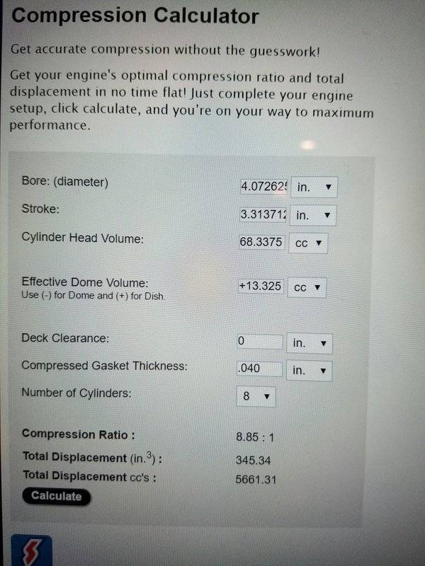

compression ratio, see pictures, also included a picture of all my blue printing and math, and used summits calculator, lol
