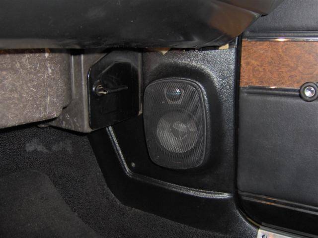

I have a set of the kickpanels in my 68 Barracuda. The speakers are a goofy size, like 4 x 6 and are cheap. The key would be to buy the panels without the cheap Chinese speakers and install a quality speaker of your own choice. I`ve seen somebody on Ebay offer them with a better Pioneer speaker. The panels are made of a ABS plastic and are a little thinner than the factory units. Oh , and the fresh air vents will not open fully if you use the kick panel speakers. There are openings in the doors at the bottom front and if you don`t mind trashing your door panels a round speaker (4.5"? maybe) will fit in there and sound very good.

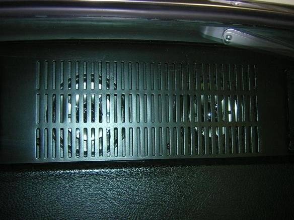

This is one of my brackets that mrbill00 is talking about.
And another...
It replaces something like this old 4"x10" single-cone speaker bracket. You can install dual 3-1/2" speakers of your choice, and it mounts in the original location without any modifications.
I make them for all A-bodies, B-bodies, and E-bodies. Send me a PM if you are interested.

I highly recommend 74 Sport's speaker bracket. I installed one and it sounds great and looks stock.
I second that! I'm very happy with the one I got from Jerry. Give him a call. :thumbrig:

Here`s mine with a set of Infinity speakers. These 4 x 6 speakers suck at bass, I`ve got a 250hz filter installed so they don`t explode!

Was considering cutting a door panel on the 73. After seeing Longgone's 4x6s, I'm having second thoughts. Those look fine to me. If I need standoffs with the kick panels, I'll use long sheet metal screws and metal tubing to keep the speaker magnets away from the body.

Here is a recent installation of one of my speaker brackets in a '69 Dart. The owner used a pair of 3-1/2" Blaupunkt speakers with no fitment problems. Let me know if I can help you with your project.
Jerry
Jerry
As Jerry mentioned above, just installed his speaker plate in my Dart. Highly recommend it and I was able to install it w/an already assembled/installed dash. Huge difference from only the 2 - 6 x 9's in the rear. :thumbup:
Any Q's on the install, PM me.
