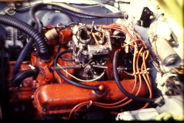

My old 70, a V code 6bbl car had aftermarket "knee knocker" AC. Somewhere around 73? I put a 340 in the car. That in itself is a long story. Anyhow, one day I discovered it would be easy to adapt the compressor bracket off the 440 to the 340. Bear in mind this is aftermarket. The drive pulley was cast iron, just "stacked" on top of the rest. So I put the "knee knocker" back in the car.
I "swept" the system with a can or two of R12, and USED ENGINE VACUUM LOL to vac the system. It was also HOT so this helped. That system was still running when I sold the car in 76? 77? Yes, it leaked!! Used hose clamps on the fittings.
This blurry old thing was taken soon after the engine went into the car, a 20K junkyard engine. I was BROKE!! (E-5 Navy pay wasn't that much back then!!) This was before the A/C went back in
