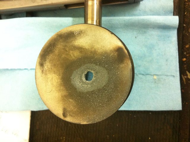

Handed me a little nitrous kit he's never used for a 2 stroke snowmobile..........
Looks like this except with bottle bracket and aluminum cylinder.
jet it fat or you gonna be rowing!
all kidding aside, definitely check your critical tolerances before getting silly with it. obviously ring gap, but piston to wall clearance and squish.
oh and timing. don't forget timing.
