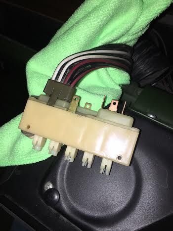

Stock unit basically exploded (back came off) within the dash with pieces going everywhere so I purchased a NOS unit off of ebay. After an intense contortion session of removal through glove box, the old unit was out and new one in with a new fuse on fuse panel.
With new control unit in the AC compressor seems to cycle randomly even with unit switched to off and temp slid over to heat. It notably does this immediately on start up for 3-4 seconds (causing idle to dip). It will also cycle randomly while driving. The compressor is a sanden unit.
Other than the compressor cycling the AC is ice cold.

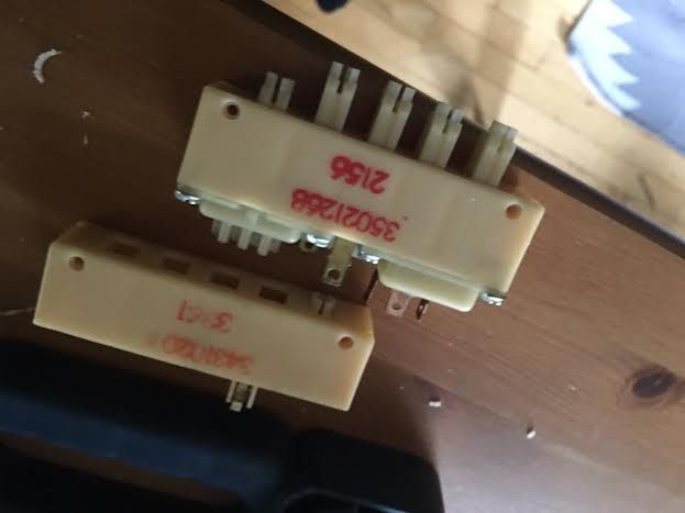

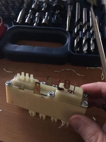

Knowing that these units are rebuildable I pulled it apart to find one of the clips on the back of the AC button a bit loose, but snapped back into place all else seeming ok just looking old. I put it back together with some screws that may not have been correct but seem to hold it together. I am not sure how the vacuum actuation works in this setup or what it does if anyone wants to clear it up for me. But... even after pulling apart it still has the cycling problem.
Does anyone have any ideas why this unit would not shut the ac off or is it possible the problem lies elsewhere not within the control box? I was careful to plug in correctly according to the attached diagram.
