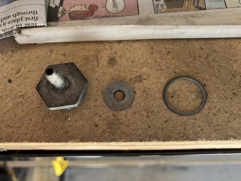

There is another kind of "adjustable" advance, which came on the dual point distributors (the ones with the hex on the nipple). You unscrewed the hex and added or subtracted washers to adjust the advance. I have never seen any documentation on how to do this systematically, or which washer pack came with which engine combo. But at one time I had 6 dual point small block distributors, and different ones had different washer combinations — for example, Commando 273 with or without California Clean Air Package.
I knew I had this photo somewhere... just took me awhile to find it. This shows the hex end removed, and the washer pack (in this case, one thick washer) for the distributor for a 1967 Commando 273 non-CAP, auto trans.
Good photo Max.
