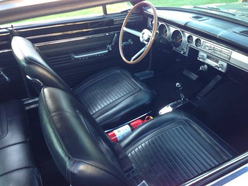

I bought a old grant "Classic" wheel, that was all faded, and worn looking at a swap meet. I cleaned up the chrome, and redyed the wood, and finished it with gun stock finish. Came out pretty good, I think.
I had to get the correct Grant mounting kit for it, and a horn button.
This is on my 66 B-Cuda stock coluum with PS.
The Grant installation kit # you need for early "A"s is #4310, you will need a horn button also. Mine went together easy, and my turn sigs work as required.

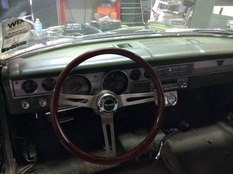

Once you have the Grant wheel hub kit to fit your steering column you can buy adapters at Amazon to mount most any aftermarket wheel you choose. Mine is a momo bolt pattern wheel. The adapter under it is 1 inch tall/thick.
I, too, use a Grant wheel. I had similar issues like 66Jim described. I made a spacer to lift the wheel away from the horn contact so the horn didn’t go off by itself when I would turn left or right.

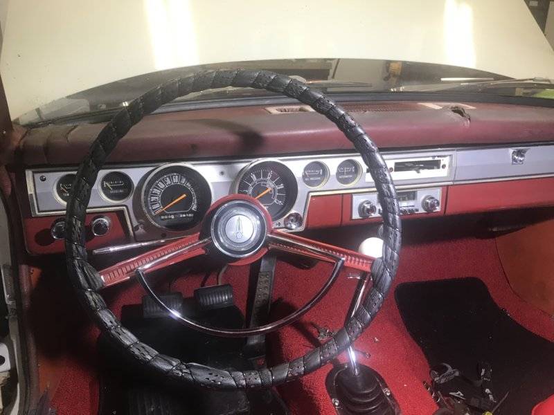

Superior 500 was on my car when I got it.
Love the look, but it was a little slippery at times, so I added the old school tie on grip.
Love it even more.
It doesn't cancel the turn signals, but it might be missing a piece, it was missing a few other parts for the horn when I got it.
I just like the look of the 500.
I bought another one, red metallic, this one is grippy, or sticky I guess you could say, and near new.
Nos mounting kits all over ebag.
I have manual steering, the wheel is 14.5, and it's a manual trans.
People always tell me manual steering must suck, but there are a few tricks to make it easier.
For example in backing up to turn around, I use the clutch and gravity so I'm not going from reverse/first/reverse, and I start turning the wheel back to the way I want to go before I'm done backing up.
