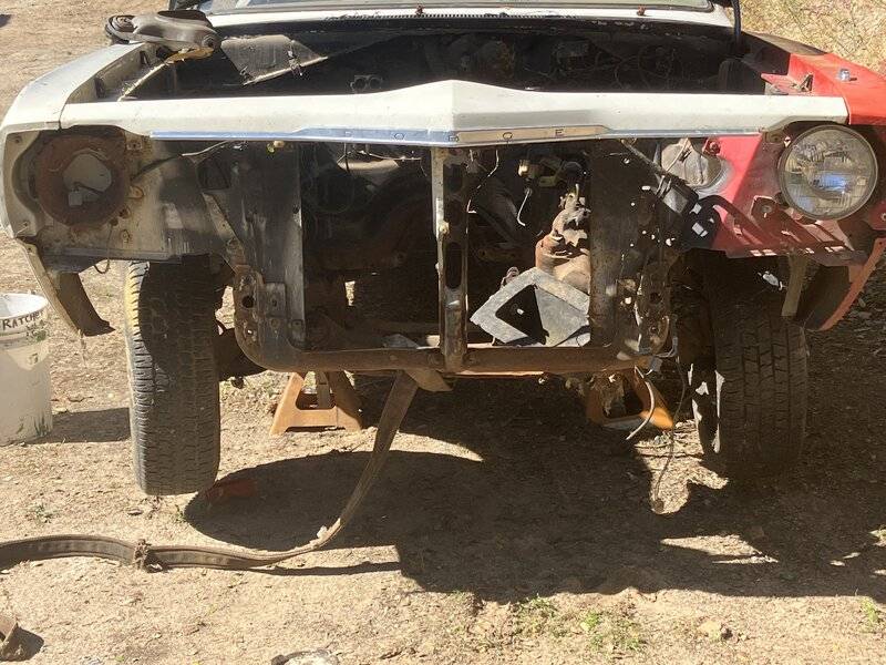

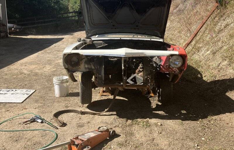

76 Dart Sport that had discs, the prior owner pulled and sold them. To make the car a roller, I put on a set of drums I had. It toed WAY in as expected.

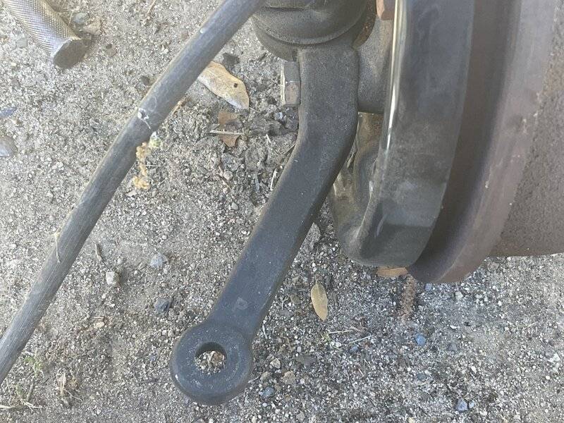

I took a look at the lower ball joint steering arm on each.

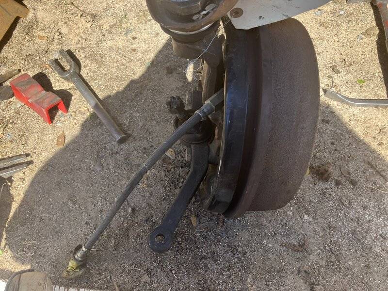

Right side Drum.
The steering arm has a strong offset to the center.

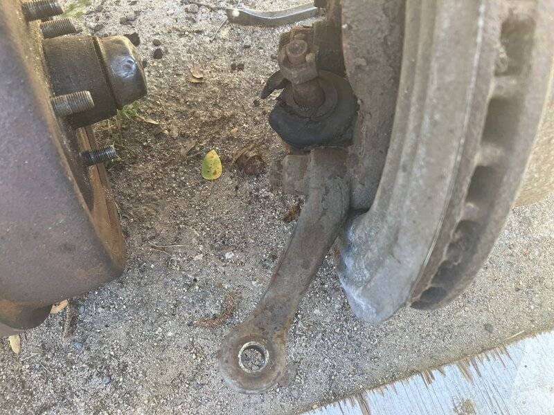

Disc setup:
The steering arm has less of a bend. Less offset.
What this tells me is that if you measure center to center on the outer tie rod ends of a disc, then a drum car, you’ll see that the distance is further apart on a disc car.

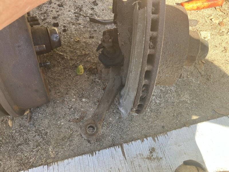

Now with discs:
Before, it was toed in heavily and now it is much better.
There are surely some members that already knew this but I thought I’d pop in to mention it for those that didn’t.
The bend to me looks like about the same angle, but the length of the drum arm appears longer. Or is my EYE deceiving me?
Different lengths? That would change the overall steering ratio. I can go measure these and report back.
I'd like to get two cars on the lift and measure the steering linkage center to center of drum versus disc.
It sure looks longer on the left. The bend even starts in a different place. On the left arm, the bend starts in front of the spindle. On the right arm, the bend starts AT the spindle.
It may just be an optical illusion though because the drum LBJ is thinner. Only one way to find out.

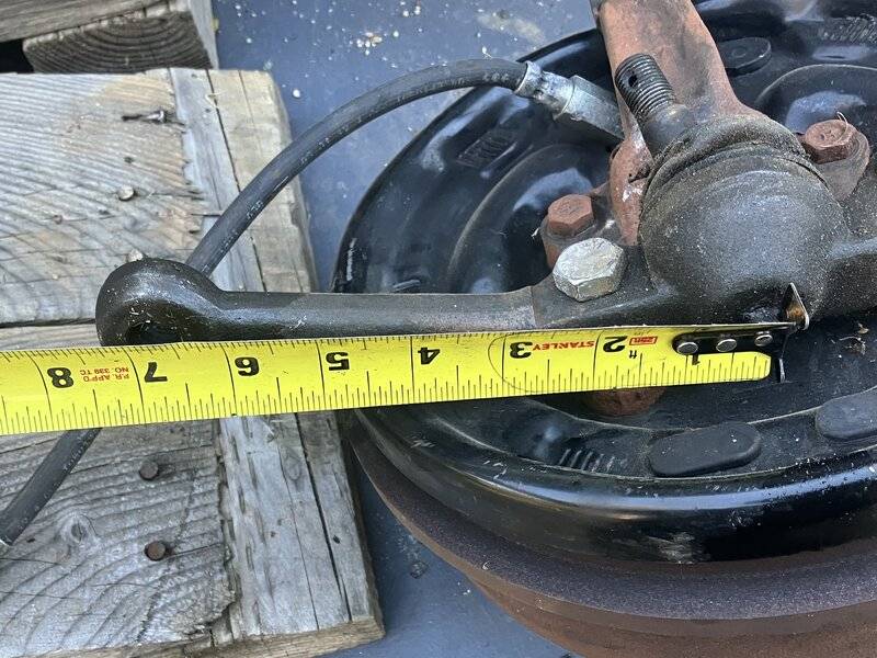

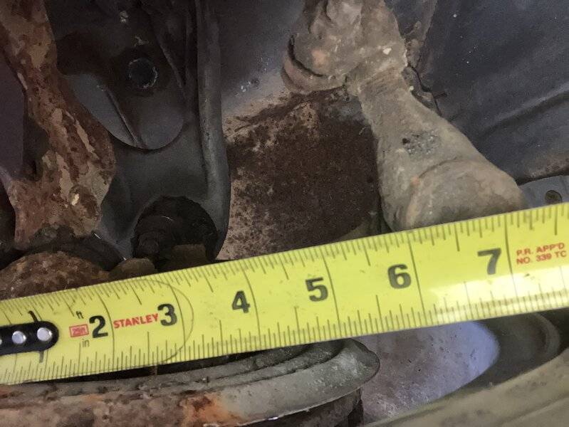

Drum:
Looks like about 6 3/4 inches from center of zero on the ball joint to center of the tie rod hole.
Disc. Looks like the same number.
It appears to me that the difference is in the bend. I’d need to measure the offset of the arm from its mounting point on the spindle.

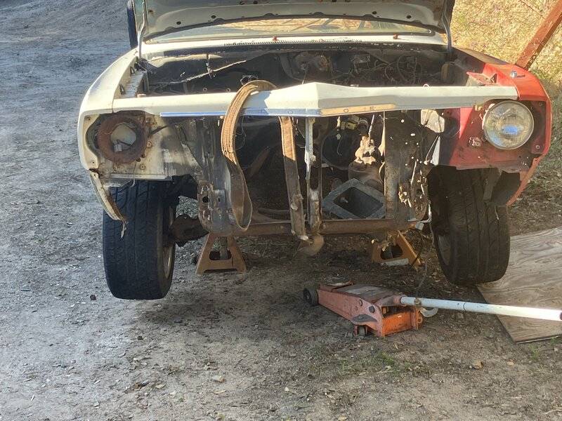

This 76 Dart was originally a disc brake car but all the stuff was gone when I bought the car. I bolted on some rebuilt drums I bought at a swap meet in 2021 because I just needed something to make the car roll onto the trailer.
