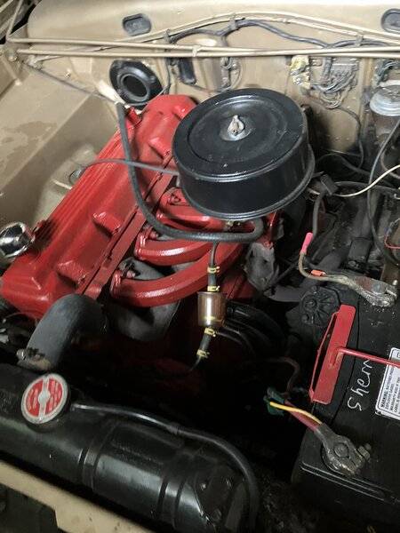

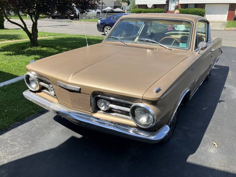

Just picked up a 65 s6 auto on floor heater delete Cuda in June
Right now dealing with a rusty coolant system and a mayo coated valve cover (plugged breather/pcv)
Have some pics on here
Found it very hard not to tear into every little thing
Previous owner had a square back alt installed with a non Mopar VR of course it’s not charging
Some wiring hacked and brittle
Runs and drives but correcting the bugs one at a time

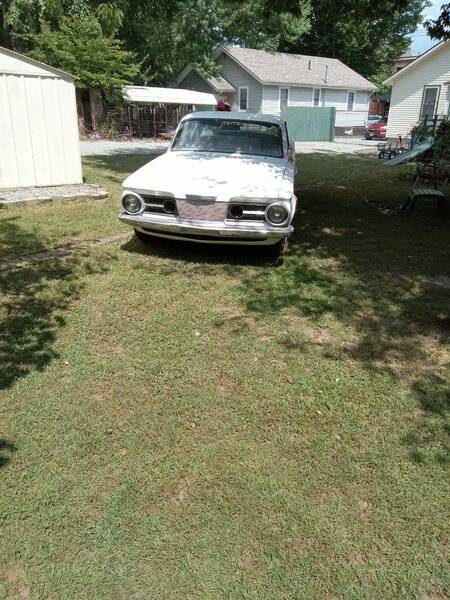

White is a very forgiving color from a body work standpoint. Both of the cars look pretty darn solid. Karrin and I have a few mostly 1965's. We like the early ones because they can be bought for reasonable prices and still have a wonderful little car. The front clip is looking much nicer. When you get the old girl all one color the before and after pictures will be nice. We had a white 67 back in the 80's but no white ones left anymore.
I guess I haven't posted a pic of the front lately. Yes, I straightened and painted the grill back to original. Pushed out one headlight trim best I could . Replaced the bumper with one I had and ordered some different parking lights . I have a nice set but they are for my 4-speed car and I'm not stealing parts from that.
I need to take a small brush and paint satin black the grill areas by the parking lights . Yes, white is very forgiving and satin white is very, very forgiving. :) Not a good pic and the areas in the paint are just shadows.
