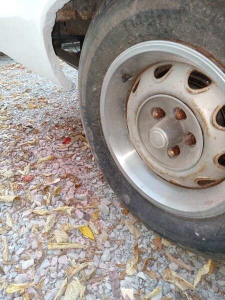

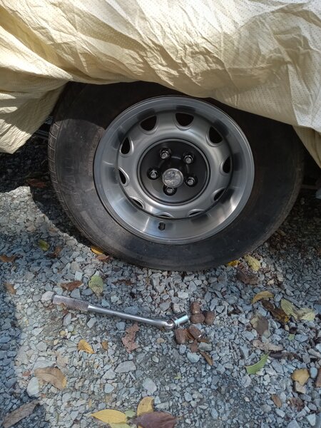

I just made a chrome sticker for the centers of the wheels. 3 of them still had the factory aluminum disc but they were messed up. I thought the chrome looked better with the lugs .
