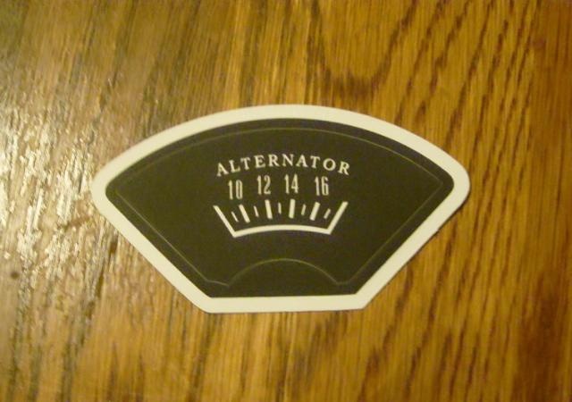

Finally received my custom decals for rally amp to volt conversion.
Shipping took exactly 1 month.
So I attempted to make my own face using Microsoft Paint and guess what.
It turned out awesome.
Just printed it on some card stock and taped it on. Looks awesome.
Thanks for the motivation.
