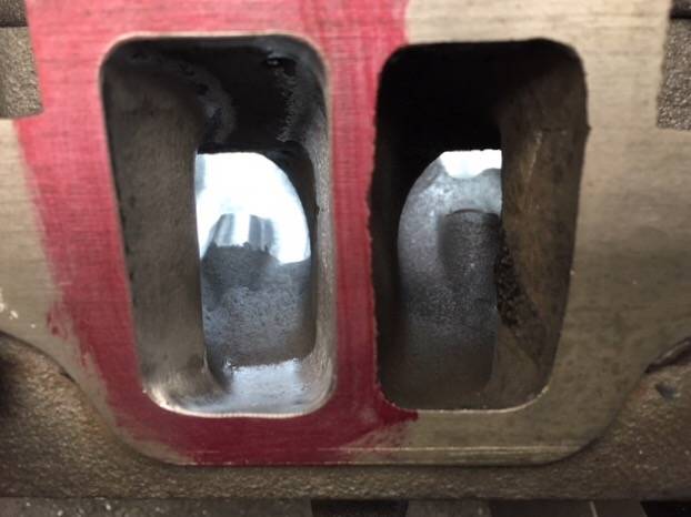

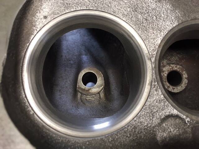

I had someone send me a set of those a while back that they had been running.
They had opted for the 2.14/1.81 valve upgrade, but not any porting.
The bowl cutter they used for bringing the bowls out to the appropriate size for the larger valves resulted in a very pronounced sharp edge on the short turn........ and the result of that was heads that flowed slightly worse than untouched OE heads.
This particular set were 452’s.
With a little porting they came around though.

A proper valve job and basic bowl blend will get a set of Stealths into the 280 range.
Regarding the heads in post #22...... in terms of BB Mopar heads.......if the choice is bigger valves ........ or........ a little well executed bowl/pinch work....... take the porting.
Doing both is best, but if you can only have one...... the porting wins.

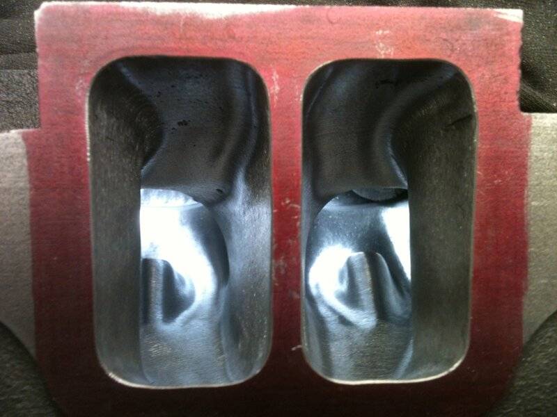

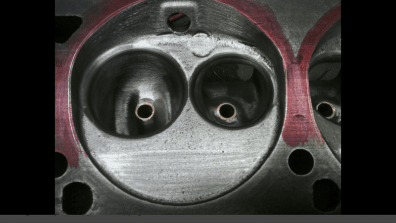

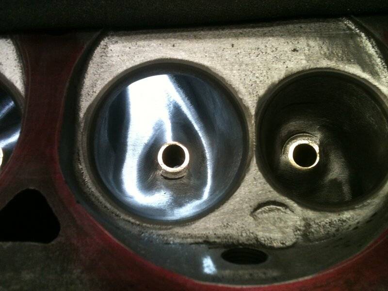

Here is a test on a 346 head(same intake port as a 452).
-recondition seat(stones)
-reface OE valve, add back cut
-blend bowl & SSR, bullet nose guide boss
-open pinch to 1.060”
Lift———I/E
.100—- 70/56
.200—-143/103
.300—-207/137
.400—-237/163
.500—-251/177
.600—-260/185
And a fully ported, but not “max effort” 346 with 2.14/1.81 valves.
I believe these heads have gone 122 or 123 in the 1/4 in a full bodied Challenger running bias ply repro tires and through ex manifolds(FAST legal):
Lift———I/E
.100—- 70/56
.200—-147/112
.300—-211/152
.400—-245/188
.500—-269/204
.600—-278/211
.700—-282/215
