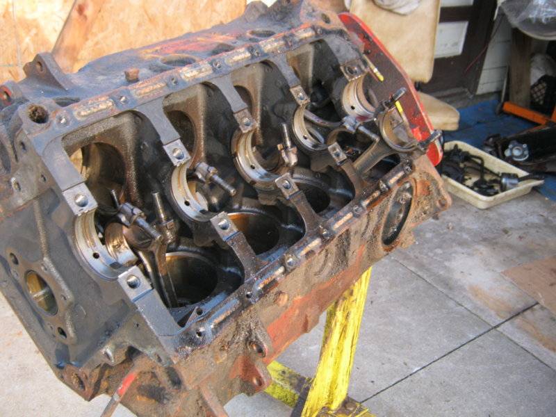

Just landed another Clean 273 commando short block . short block is completely taken apart except for 6 pistons and rods .. crank is out . engine is with stock specs . all standard bearings .. I got 2 pistons out , rest are stuck.

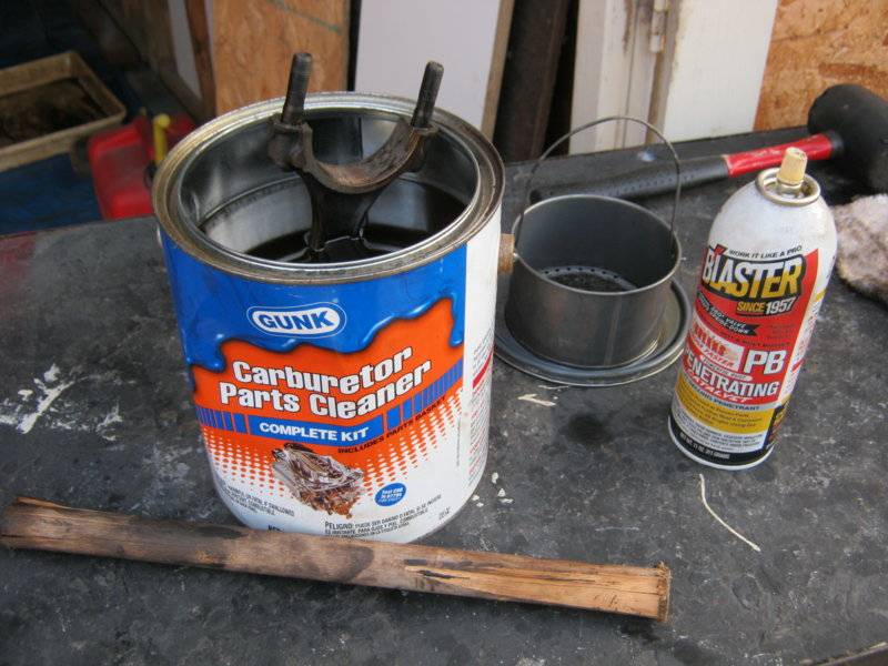

Question is ...... what solvents are you guys using to free up these stuck pistons in the bores also ................ to loosen the rings in the piston lands ? I tried the blaster , tranny fluid , acetone couple other penetrating oils . I filled the bores (4 at a time ... on side ) with penetrating fluids and trans fluid to cover the 4 pistons in the bores and letting it sit for a while. Oh yeah..... I have one piston soaking in a gallon can of carb cleaner. Thanks !

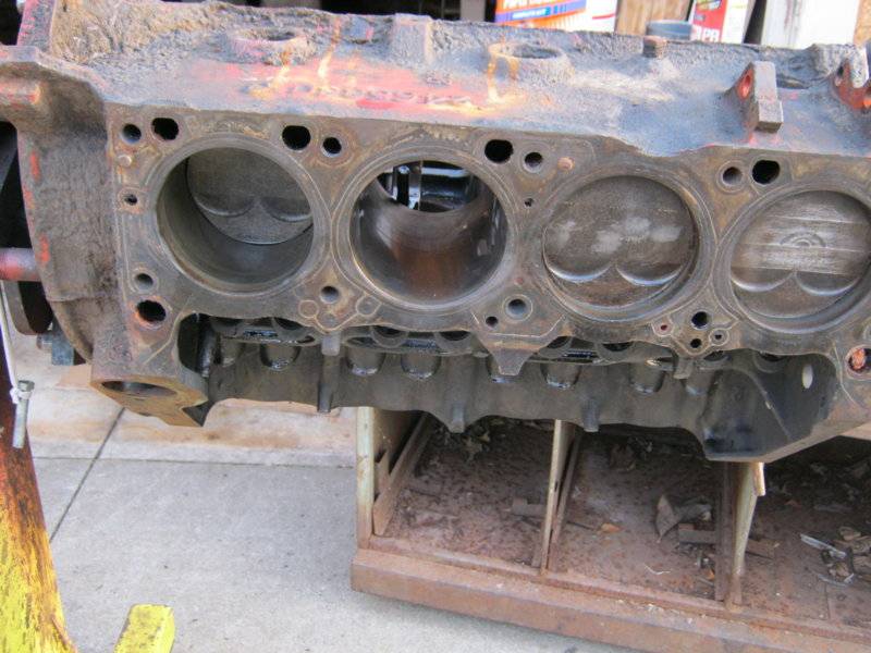

If the cyl are rusty get the rust off before removing pistons, I put the cyl down and use oil soaked 220 then 320 to clean the cyls then whip them out with WD40 on a rag once clean I use a wooden dowel rod to tap out the pistons
I have and would run a hone in the holes for the stuck pistons so when they do break loose they come out easier. I used Deep Creep soaking for 47 hours before using a block of wood tapping both ways and got them out. I have not tried it but heard Coke-A-Cola soaking will free them.
cyl walls are all very clean , don't see any rust at all.

From the photos it looks like the motor could be stuck from bad gas being run thru it before it was shut down.I had this happen on my 48 Plymouth after a long storage.I was young and didn't know any better and fired it up after letting it sit for 3 years.Went back a week later and the motor was rock solid. I pulled the plugs and filled the cylinders with Marvel Mystery Oil and let it sit for a month.When I went back I put a battery to it with the plugs removed and spun it Then she ran fine. Those pistons may not be rusted in place is what I'm getting at so heat and oil may free it

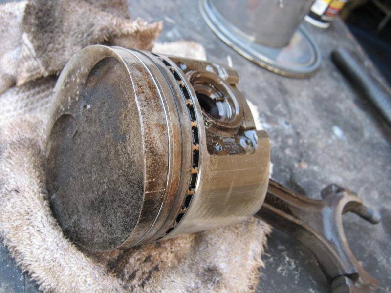

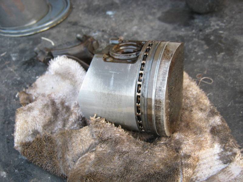

The other thing you asked about is how to deal with stuck rings, I've had reasonably good luck with this method. I soaked the pistons in dip parts cleaner ( you have your Gunk, good start ) to soften/remove carbon build up, rinsed that off and then working one ring at a time, took a small ball peen hammer and lightly tapped the the ring into its groove, start at the gap and work your way around. The good sign you'll be looking for is when the portion of the ring opposite where you tapped it in will spring out.
As I said, I've had reasonable luck with this method, one ring would not give up, 2/3 of it was free around the piston, the last 1/3 just didn't want to give up; so I broke the ring and dug it out with out buggering up the groove. I reused these pistons in the first version of my "Mean Teen", went 13.92 at just a lick over 98 mph.
