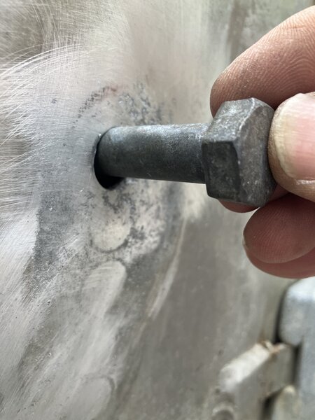

All four holes were “adjusted” apparently. I’m a little more anal about through hulls especially ones with so much angular forces directed on them. What would you do?
I fashioned some spacers and JB’d them in to reduce movement….
Then I’m supposed to 5200 the crap outta them like putting on an intake manifold… TBC
Your repair looks great! I would think that's about as good as you could do it? Other than tig welding?? What do u mean 5200?
View attachment 1716281652View attachment 1716281653

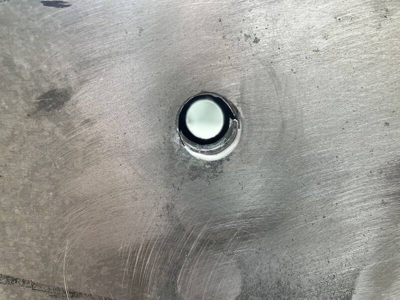

Should have had it welded when I had the cracks done. I’m not so sure that may have caused my issues on the inside plate of the transom.
But I didn’t want something like that going on where the outboard sits flush on the outside. The motor is tight on my “shims” and I used the sealer on all 4 sides of the plates. The transom is hollow! One 0.125” plate outside and a double layer inside.
3M makes two marine sealers 5200 is semi permanent but still flexible. I think 4200 is more like a caulking??

Should have had it welded when I had the cracks done. I’m not so sure that may have caused my issues on the inside plate of the transom. View attachment 1716283614
Hard to believe the transom is hollow
I know right? I was thinking wood or something. Nope, one piece of aluminum support in there like a baffle in a tank just below the lower motor mounts. That’s it!
You can always add another layer of alum if you want
If it were two new aluminum plates and sealed perfect, yes. A new plate on an old one (that’s not perfect anymore) can lead to corrosion in that space.
