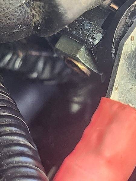

So starter doesn't appear to be working. Of course this was after taking last part of day off work to fish and i unload it in the water. I thought it was batteries but they both load tested fine.
Bendix on starter seems "lazy". Will not turn motor over. Put rope on the pull start and am able to pull it over. It is snug tho. I dread the day I have to do that on the water.
I removed it and tested on shop floor with battery, bendix shoots out fine and spins good.
So I reinstalled, had lori try to start.
1 get 3.7 v at copper stud(1st pic). Then I chk main battery +ve on starter while key is in start. I get 12.5V there.
Suggestions? It's like it's lost it's torquing ability if that makes sense.

Saw video. We're it mine. I'd take the black solenoid apart, and see why the contact that jumps elec across those 2 big wire contacts isn't jumping. It's usually a big copper washer, sometimes the contact areas just "wear" away, or whatever secures the washer to plunger fails. Often, washer can be flipped on plunger for better contact surface.
I take em apart just to see what's what.
Good luck
Or just replace the black solenoid if it's avail.
Fixed...for now. Replaced a couple -ve wire ring terminal ends at battery...
The starter and solenoid both seemed to work fine when removed, so if getting proper power, it should work. I figured a terminal replacement may help. I noticed one wire has a decent amount of black junk, so a wire replacement is in order there.
