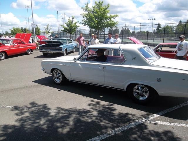

Here's ddartdude's old D/Dart in Seattle several months ago. he shared with me that the particular motor in this car is a 273 2 barrel motor with modern dogs headers, a alter model aftermarket intake a Holley 1850.
