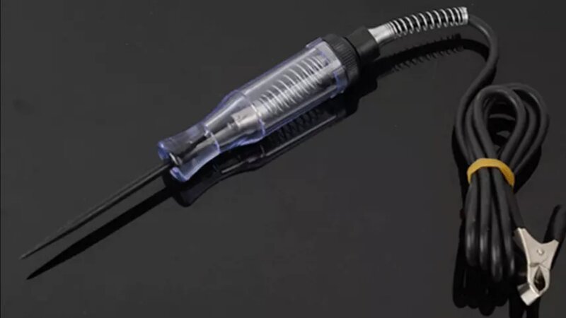

Remove the plug from the sending unit on the intake manifold.
Clamp your test light ground clamp to + positive battery, them touch the pointed end of the test light to the temp sending unit.
The test light should glow orange on a cold engine, as the engine warms up it gets brighter and brighter.
Can do the same temporary setup with a (side marker light) 194 bulb and socket wired in the same. Gets brighter as engine gets hotter.
Then you can concentrate on the other 2 electrical issues.
