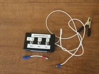

I have a sender simulator I made to troubleshoot gauge problems. I has switches for empty, 1/2 and full. It also works for temp and oil gauges. You can borrow it if you want.

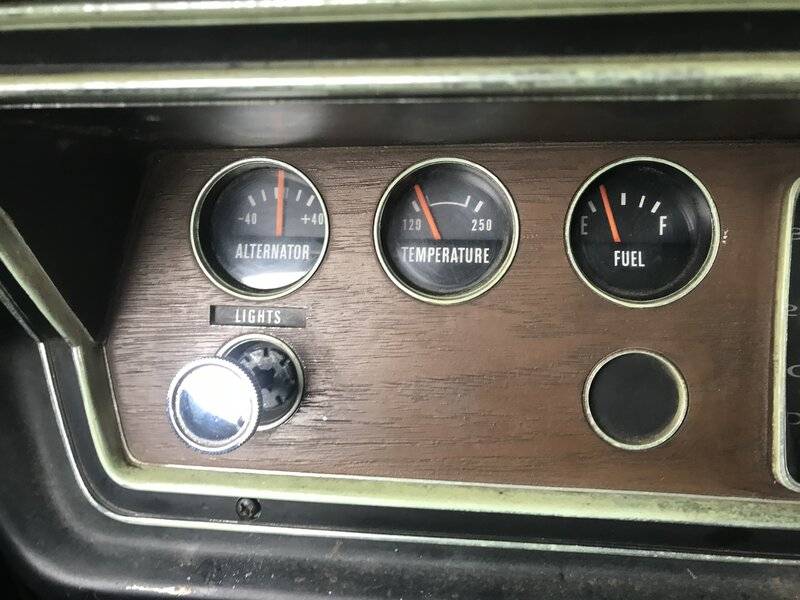

Presently the temperature gauge reads low even when the engine is at normal/high operating temperature.
Operating temperature is not always the center of the gage.
At this time of year in most of the US and Canada, be lucky if the thermostat opens fully afte the car has been idling or doodling around. Something around 180 to 190* F.
After a long drive uphill, or a couple hours at freeway speeds, might get that up to 200 to 210*F.
In hot weather it will run a bit hotter.
Anything between 170 and 230 is normal warmed up temperature as long as it makes sense based on conditions. Immedietely after shutting the engine off, coolant temperature will rise a bit.

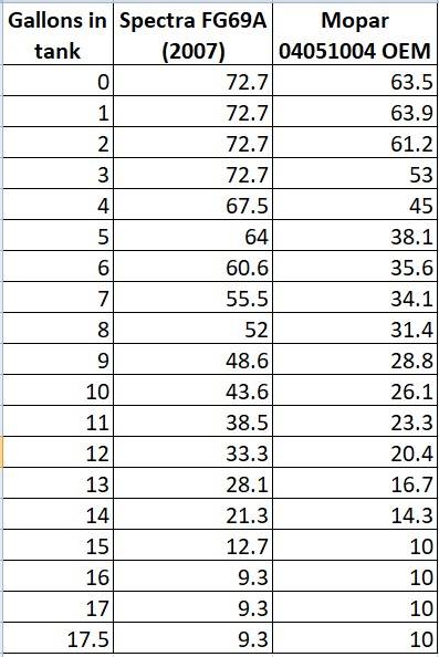

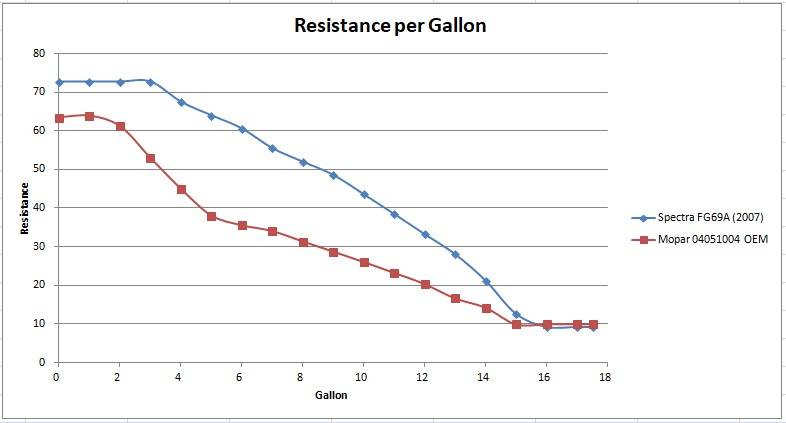

The basic issue is that the A body gas tank has a big scoop out of it on about the top half to clear the spare tire well. Since the top half of the tank holds a lot less gas, the fuel level drops a lot faster in the tank. The factory senders are non linear to account for the tank shape. The float arms are also much longer than the aftermarket.
The aftermarket senders a a linear design and do not account for the tank shape, so they don’t work properly. The float arms are much shorter as well. The gauge drops fast from full, because there is not much fuel in the top half of the tank. The float arm length also influences this.
Below are a couple of charts I pirated from somebody else on the forum to illustrate this.

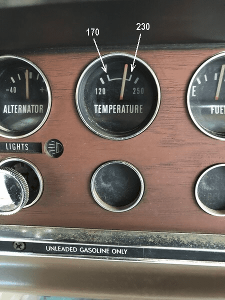

This is where I am running right now:
Maybe it will read higher in the summer. If this is not considered a “too low” reading, and I can be assured the gauge will spike if my temperature increases, again I can live with this. I tested resistance at the sender, and I’m confident the sender is functioning properly.
That could be thermostat stuck open. Have you checked actual water temp?
Yes, I have recently ran a mechanical water gauge and checked with an infrared pointer. I know the engine runs at 180-190

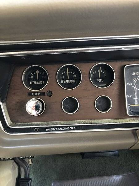

This is where my needle is at operating temperature with resistance at 24:
Am I wasting my time changing the sender?
The needle should be mid scale at that resistance BUT "is the resistance" actually appearing at the gauge stud?
The path is engine block and ground, sender, sender wire end terminal..........through the bulkhead connector terminal............to the cluster harness connector.........the pc board pin.........to the pc board trace.........to the gauge stud and nut. Any of those points could be a poor connection, OR the gauge wrong, or not getting proper power from "the other end" of the loop.
If you are sure you are correct in your measurements, and can check it clear back to the gauge, then I'd eliminate the sender and sender wiring.
