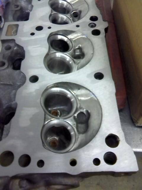

The heads heads i'm running flow his peak by .400 lift. 215 @.300
His saturate/stall , I think he could fix that with some ssr adjusting, even it out and leave a lip at the top. Seeing what it looks like would be helpfull to visually determine.
i will get some pics, like i told the head guy i do want critiqued. and don't be easy on me. I'll listen to the good, the bad, and the ugly and meditate a while before i fire the air compressor back up. That being said, I've been reading and listening to mopar guys forever. It seems like just recently, and i don't know why, maybe the company i keep has changed or technology or something else. But the SSR was always Taboo " don't f@%k with it!" I'm having a hard time crawling out and shaking that off. Can someone please help. My brain is hungry!
