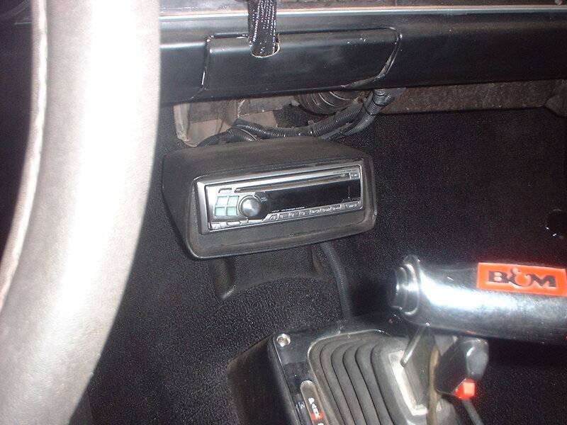

Mine worked great. Never skipped a beat. Volume controlled by my right foot
