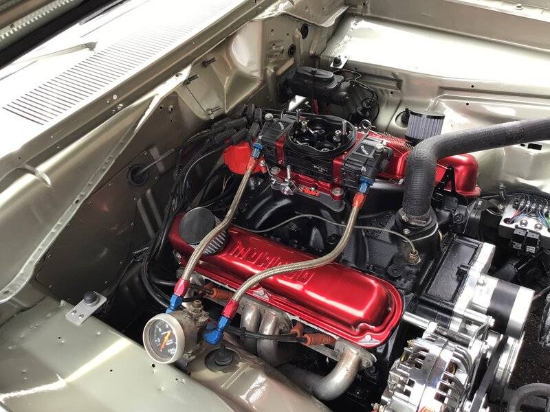

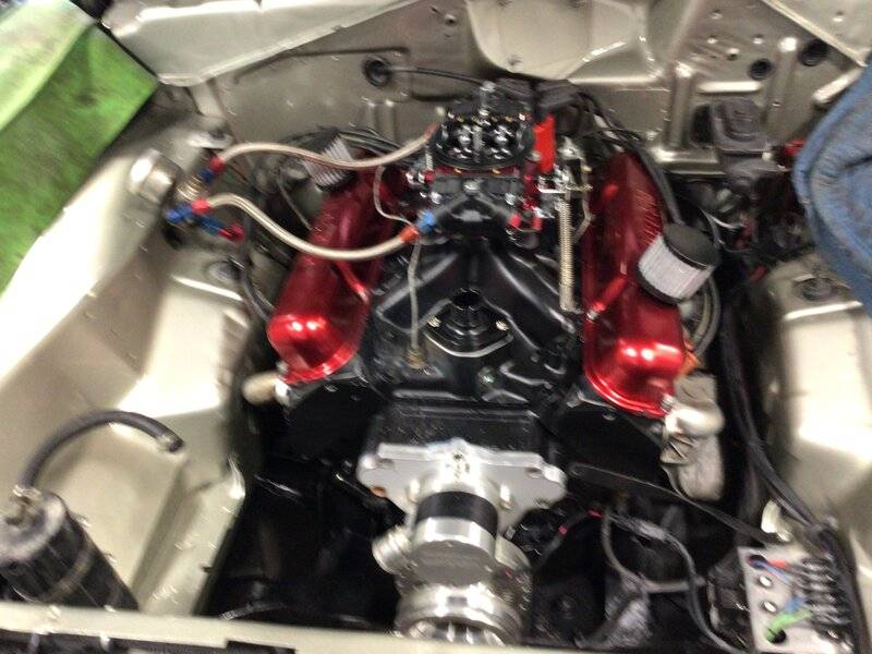

I've read through this thread and while I don't claim to be able to follow the science, I'm guessing that if black is a cooler color I should be able to hang meat in the engine bay on this spray-bombed beauty. :eek:
