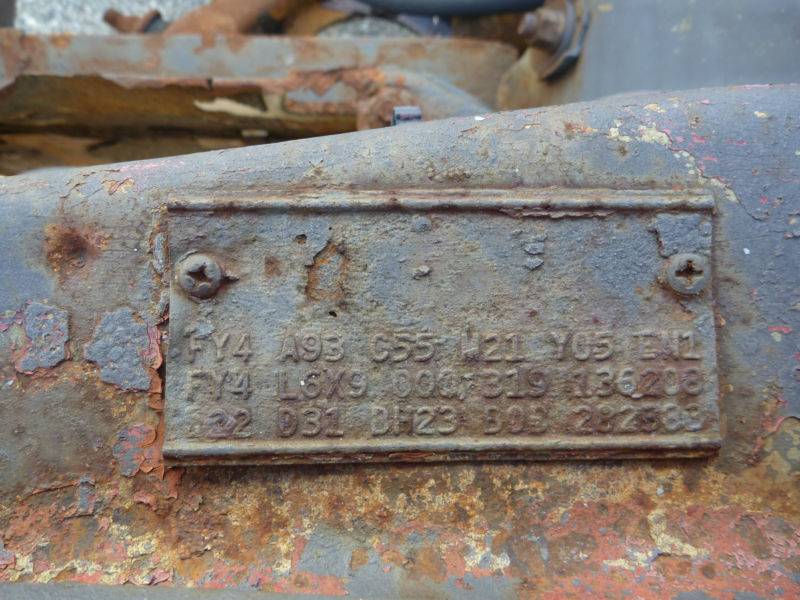

Cuda Hunter is right depends what the 198 is in. I guy I know that lives close by, a real Mopar enthusiast. Informed me and E-mailed me pics of car and a pic of the fender tag. He just acquired a B0B Barracuda, 1971 Barracuda triple black, 198 Slant6 with 3-speed manual on floor and magnum road wheels. Built in Hamtramck but found its way out here in SoCal. A very straight and great looking car, was not running but is running now. Price paid 35K for an A93 Coupe all black. Not many of these running around.
/sixchall
Jan 19, 2017
295
158
Riverside ca.
Special Slant6 in this case a 198 Slant6 (B) year built 1970 (0) built in Hamtramck (B) B0B. I should have said B1B for an A93 Coupe built in 1971. Cuda Hunter knows here. Hope it clears up for you.

Volaredon, Glad to help the A93, (which is a code on the fender tag) would be the Barracuda Coupes and the Challenger Deputy, both had the 198 Slant6 and a 3-speed manual trans, they were usually pretty spartan in options if any. So hence the B0B and B1B as part of the VIN.

@/sixchall Is the fender tag listed anywhere for viewing? I would love to see it and decode it.
As an example, here is my A93. 1971 coupe model. It's a C. I have yet to own a B, an R and a U. Always looking though.

B1B '71 Demon with D13 transmission (rolled off assembly line on Sept.19, 1970).
The 198 is still present in the engine bay, just as the (on floor) 3 speed transmission

Thanks “Cuda Hunter” for your contributions on this post. I do have a copy of my friends 71 Barracuda B1B, A93 car. I will ask him if I can post a pic of it here to you. Right you are about the non roll down quarter windows. The car itself is in really great condition, even the paint can be cleaned up to bring it back. Interior is real nice and shows what an A93 interior is all about with 3-speed stick poking up thru the floor. My Slant6 70 Challenger out of LA is a “C” code car. I have researched it and I believe it may be the very first 6 cyl E-body to be built on the LA assy line. Aug 18, 1969 first Mon of volume production. Here is my fender tag.
