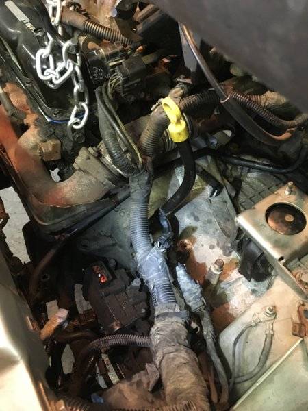

Harness from ipm goes down between trans and rad, there is a chance a wire is broken, like a fuel pump power wire.
Cant be anything major.
Wires that run low get beat up and during swap they may have finally broken.
No code stored? I bet its fuel pump.

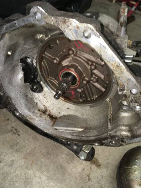

Dont recall if crank sensor is in bellhousing, if it is it may be damaged. Have seen it before.
Ok. The flex plate is the trigger for timing,would think if it mounted to crank the same it would be fine. Crank sensor mount is slotted?
The new sensor had a paper disc glued to end of it to set the depth or air gap.
If it goes in too deep they get whacked by the trigger holes and distort the signal.
crank sensor is in the bellhousing. It did look like it took a little hit. Still works (says scan tool)
Had an intrepid that showed sensor as ok,is it registering rpms during cranking?

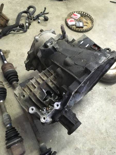

The sensor cracks if it isnt removed during trans swap. Or if chunks float around when trans demolished itself. I saw lots of carnage from those pins sawing through the case.
It doesn’t show rpm’s steady just for a second than back to zero.
Theres your clue..
If you go to any fuel injected vehicle, disable fuel pump and crank engine it will register rpm during a crank cycle.
Some engines will run with a dead crank sensor, but not with one that has an erratic signal.
