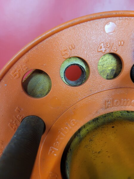

sorry, i forgot to hit the attach photos. here they are. i don't thick i would be afraid of the dual bolt pattern as they are the same as wheel pattern but the pics should help. thanks for bringing it to my attention.
1st pic is with my bc gauge on it. it is 4.5 bc. 2nd pic is of hub turned a little so you can see the 5 in bc number. the other hole lines up with 4.75
I've got a spare set that has 4 and 4.5 bolt pattern but it's Wilwood. Just surprised it has a GM pattern 4.75 and 4.5 Ford/Mopar
As an owner of two sets of JFZ brakes, I can assure you they are NOT wilwoods. What you have looks like a mismatched mess to me.
The 4 1/2-4 3/4 double pattern is completely normal.
JFZ went belly-up several years ago, but somebody is still making pads for them. Could be wilwood.
I called strange this morning and was told the jfz stuff was bought out by wildwood and that they may have the o ring kits for the calipers. Strange does not as they made their own for their kits. What spindlesdo/did you use?
not sure how old the calipers are, but i measured the pistons and they are 1.74 diameter, 4 per caliper and the caliper has a metal transfer tube at the end of it, made from steel brake line. did not have a chance to see if piston seals are round or square cut, but will look tomorrow.
No sir. It is 4.5/4.75
Nothing weird about it. It's a Ford/GM kit. Ford used 4.5 bolt circle and GM used 4.75. If you're going to the Mopar 4.5 bolt pattern, have fun, it should work with all the right pieces.
