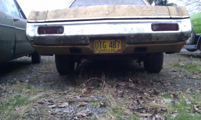

I bought a Scamp parts car that the owner did that to. He cut the bracing under the bumper to run the pipes. He made it look like a 70-74 Cuda -rectangle in the pan. Didn't look bad at all. I still have the pan for sale . May still be a pic of it under scamp parts car for sale back in march or so..
I looked through your post and found the Scamp parts:
attachment.php
