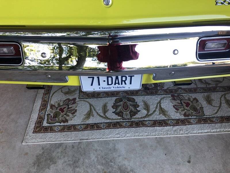

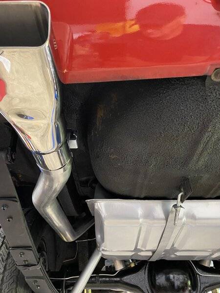

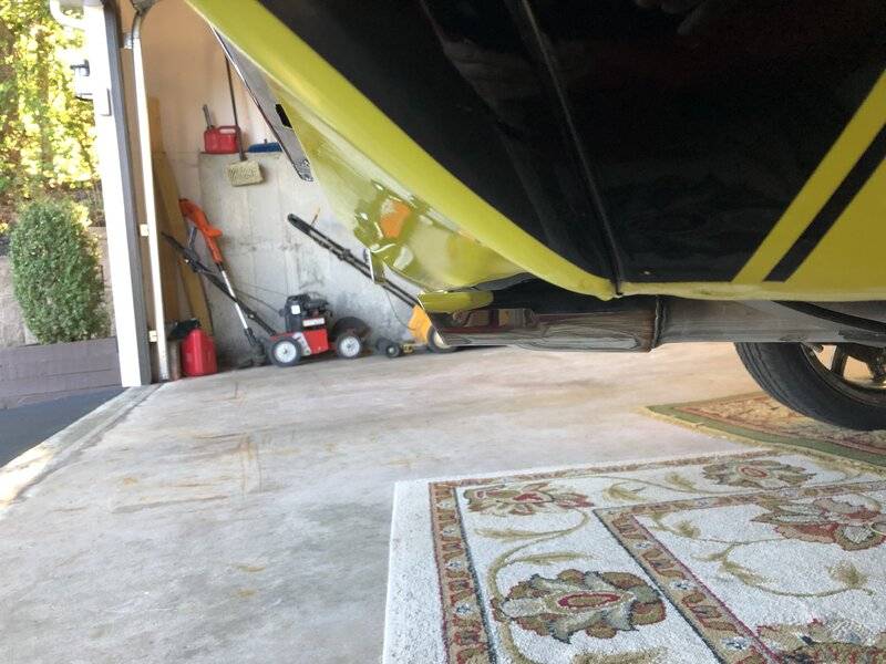

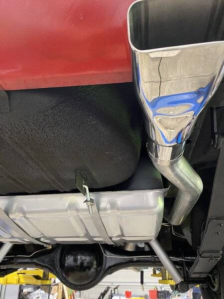

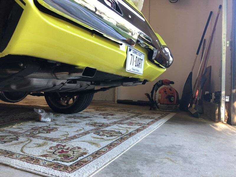

I feel your pain. Went through this a couple of months ago. TTI manifold back 2.5” system. I was going to use factory style tips( from accurate 2.5”) to add to TTI system. After getting system installed I realized to get factory style tips to work major mods. Went with TTI tips. Happy. Included pics to see results.
Nizze! Are those the TTI tail pipes with the bend in them or did you have straight pipes modified?
I see that the TTI tips are 1 1/2" shorter than the ones I bought (12 1/2" vs 14") and I assume they have no hanger provisions. I will make what I have work.
