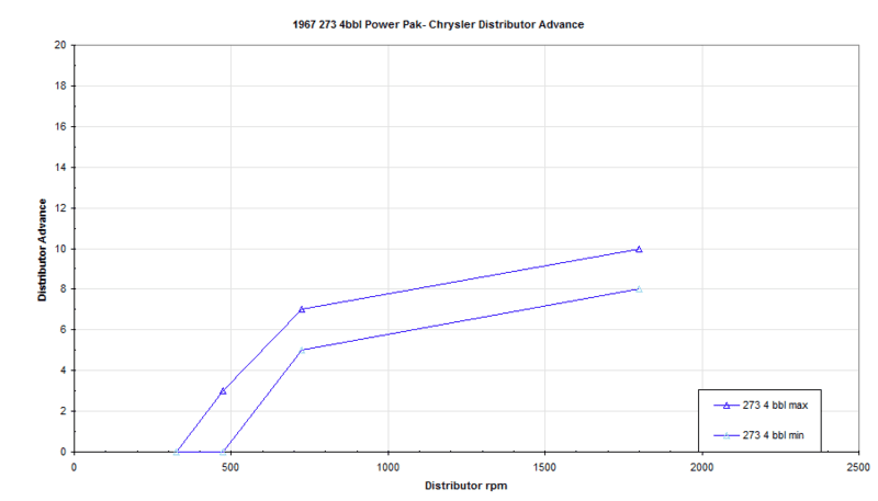

That's 11 degrees of distributor advance, 22 at the crank. It will be a little less on the engine unless running points.

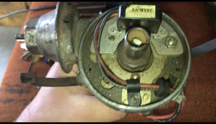

I’m not going to mess with that piece. I don’t know where the spare came from. But, it says 11 R for right rotation. The one on my current distributor says 15 L for left rotation. I about have it back together. Is there a trick to reinstall that little clip ? I also found in a video, when you swap to a lighter spring. You should plug vacuum canister. Is that right ?
If its a straight slot, as far as I can tell it doesn't matter - at least on the magnetic pickup units. Some have angled slots - that's a different story then.

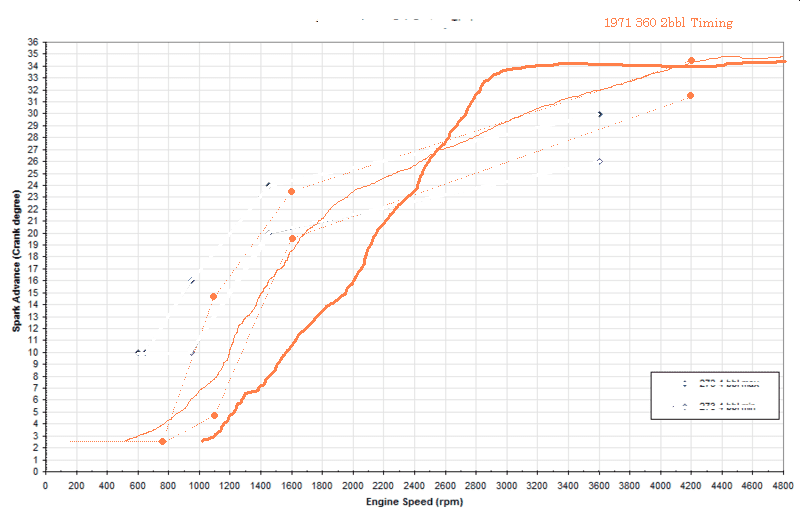

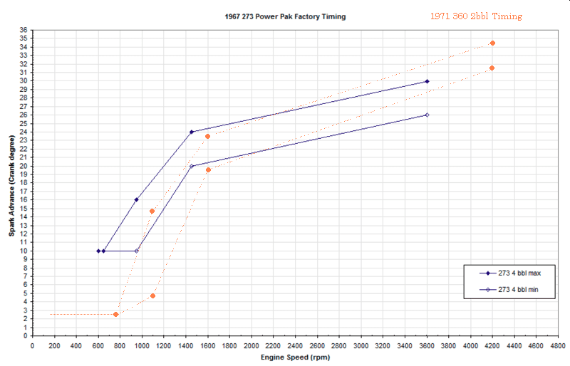

Here's some timing measurements of a DC/MP vacuum advance distributor on an engine.
Advance in Crank degrees, Engine RPM.
If the engine could have been idled below 900 rpm we would know if the initial timing was 12* or something less.
I suspect it was actually a couple degrees less. This particular engine would have liked 16 - 18* initial.
Anyway you can see in the timing plot how the two springs work.
We can also see it in the advance specifications in most of the shop manuals.
Converting the advance specifications to crank degrees and rpm, and adding to them the recommended initial timing of 10* BTC, the acceptable range on an engine looks like this

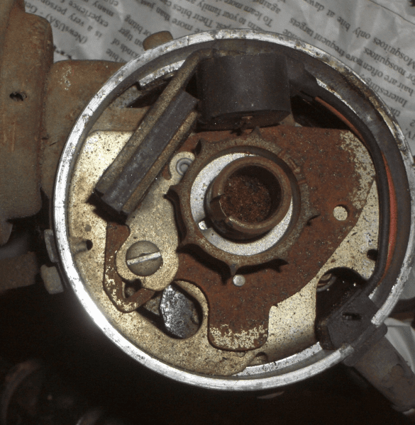

Points distributor. Converted.
'72 360, Dodge Truck?

'71 Plymouth FSM only has 2 bbl 360 listings - and they have long advances, 14-16*. With initial timings 2.5* BTC. It has a fast and somewhat long initial advance so off-idle the timing will be where it should be for power and economy.

Yes points, converted to electronic. I looked the engine number up a couple years ago. And if memory serves me correct. The engine was installed in vans and trucks. But, I’m sure it was also installed in a couple car models too as the 360 was gaining popularity. How in the hell did you access that additional info ? Mine has an unknown larger cam and it doesn’t like anything less than 20* initial timing.

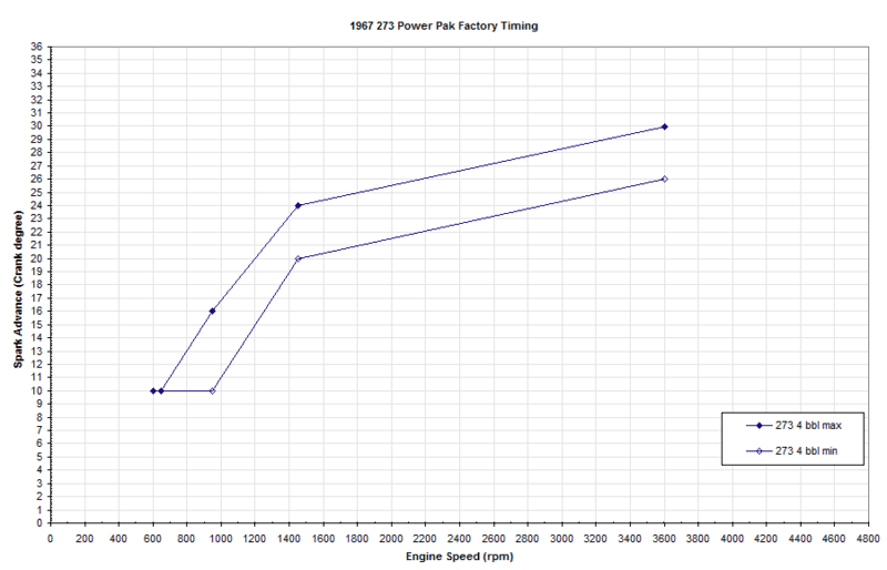

So if we compare the non-emmision 273 Hi-Po 4 bbl to the 360 2bbl with emmissions
Initial timing: 0-5* initial timing may have been because the 360 had more effiicent burn at idle than the 4 bbl. But we know from Chrysler's tech booklets that the initial timing was reduced to insure increase the heat in the cylinder walls and exhaust gas. This reduced left over CO and hydrocarbons. They also ran the idle mix leaner. So this combination reduced power at idle, hence the higher idle rpms (750 vs 600 or 650)
Advance to 1600 rpm: This is long and quick to get timing up to where it ought to be for the 360 to have max power.
Advance above 1600 rpm: The engine is in the range where combustion speed is increasing with rpm
Advance above 2400 rpm: The 360 2bbl engine, probably due to the cam, is less efficent at WOT than the 273. So it need more lead time for the burn.

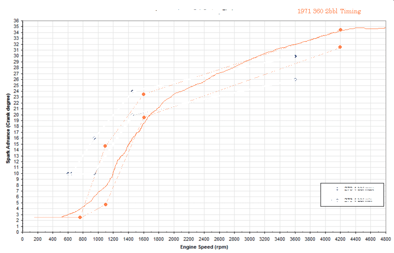

My suggestion for your engine. Because the 360 had an early smog curve, the first thing to do is fix reduce the iniital part of the advance curve.
What you did will be OK for a drag race only use. But shorten the total advance by using the 11 plate. That with the two primary springs you now have, should get it into the ballpark. With about 20 degrees of crank advance, work toward getting the initial closer to 15* BTC at a lower rpm and experiment with making the idle mixture richer as you do this.
Lets say the advance curve in your distributor looked like this.
Putting a second spring on it changed the curve to something like this.
But your engine doesn't want an initial timing of 2.5*
I don't know what rpm you measured 20* at.
For sake of discussion, lets say it was 1000 rpm.
This is why the overall advance needs to be reduced from 30 crank degrees. Even if you end up getting the initial timing down to 15* at 800 rpm, 30 in the mechanical advance is too much.

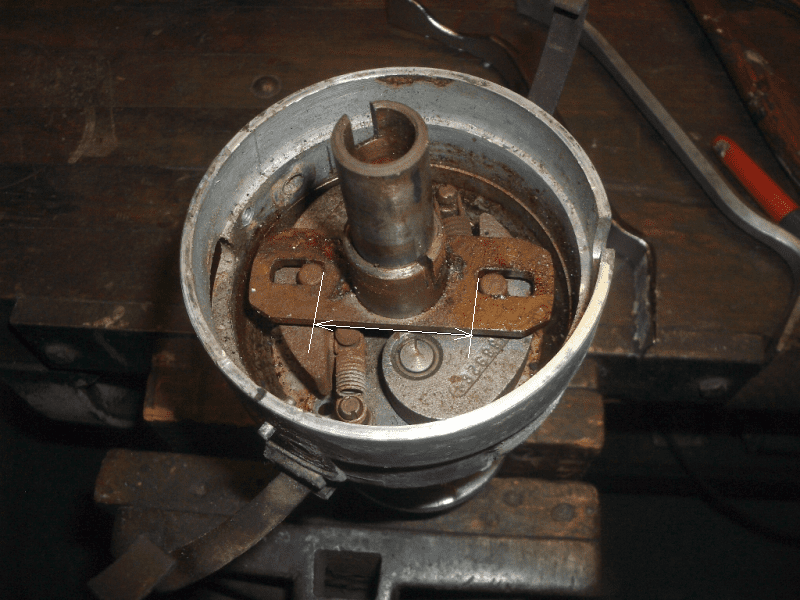

Also when you have the governers out, measure the distances between the inside stops of the slots. Knowing if they are the same or different makes it easier to set up the distributor to do what you want.
Without measuring. I put them up to one another bottom to bottom and they look exactly the same in reference to distance. I reinstalled the distributor with two identical lighter springs. I ‘ll know if I like it or not in a few days. If it doesn’t run right. I’m not going to piss with it anymore and swap the bigger spring back in.
