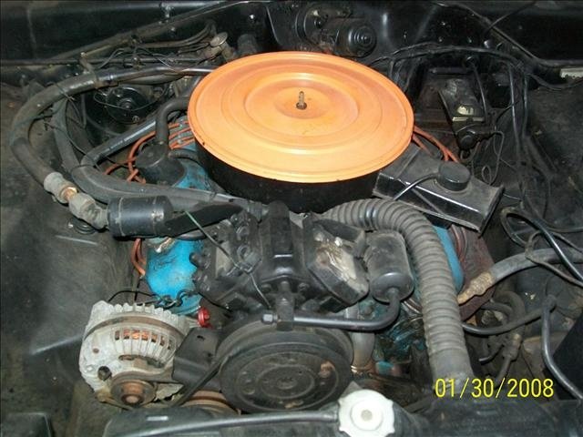

Don't have the digits on the side of the block and not really sure how to tell the difference. VIN says it originally had a 273. Thanks.
Where have you looked for the numbers? They are on the drivers side and pretty big raised numbers. They will be in a series with other numbers.
From what I see. It's a small block. That's about all you can tell from the pic.
Need some numbers of some kind.
A looked on both sides didn't see anything. Unfortunately don't really have a chance to look now since this was just a car I went to look at.
Did you crawl under the drivers side of the car with a flashlight?
xs2My guess... 70 and up 318 .
all 273s were Red and all 69 and down 318s were Red / ( Orange Police )
Due to it being a Blue 2bbl ill say 70-up 318
