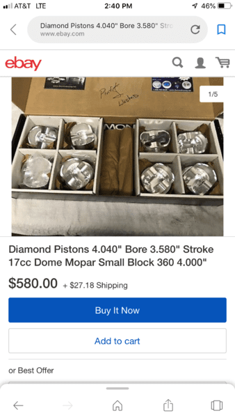

Here are some I found of eBay.
Oops sorry I missed the part about wanting to lower the compression
