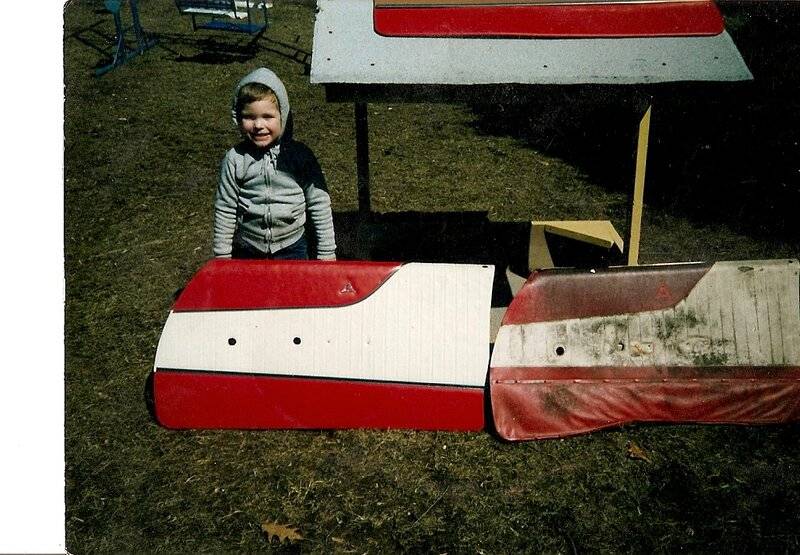

I did dig out whats left of my panels. 64 Savoy and 62 Lancer. Bioth OEM used masonite.
THese ealy B bodies have a metal plate at top of the panels. I have to find out how good of a pneumatic staple gun I need. They stapled the vinyl to the back side and I am told used 3/16 leg staple for that.
