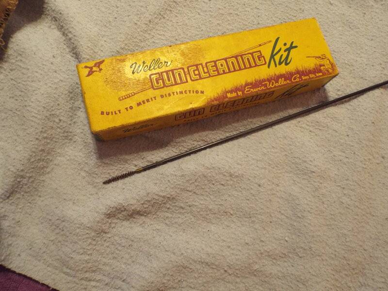

Yeah, almost 100% sure I have one in a kit. I have a Ruger .177 break action pellet rifle. 1250FPS. It'll put a pellet through a dog's skull.

You mean like this? Lemmie go see if I have some connectors.

I haven't cleaned it using that. I just happen to have that size brass brush in a gun cleaning kit.

LOL I ain't trynna clean a GUN, man. I'm tryin' to clean Mopar connectors.

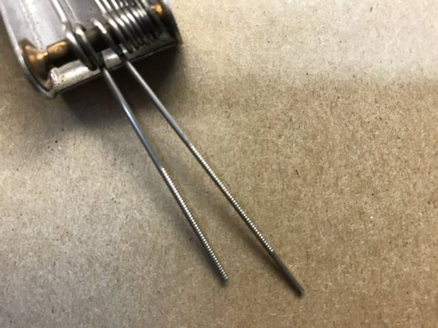

Cut the smooth end off a torch tip cleaner and run it in and out several times, working it around in the socket. Flush the contact with cleaner. This does a nice job. And it’s not aggressive enough to remove any metal.
