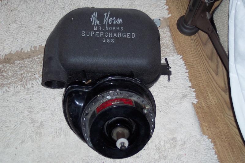

Wondering if there any issues with the paxton and what kind of real world gains they can provide.
Anyone sell a turbo kit for a small block A body? If so where should I start looking?
That's a cool setup! Very period-correct and should make that 340 flat-out fly. There's a company that does these Paxtons up to add 3 to 4 extra lbs of boost with a more modern impeller.
attachment.php
I found a company that sells a complete Paxton set up for a small block A body for $2500. It produces 8 lbs. of boost @ 6000 rpm. Not sure what kind of gains would be expected. Is 8 lbs of boost to much for 9.8:1 comp motor? Wonder if it would run fine on 93? I figured maybe someone has been there and can share some helpful tips so my investment wont be a total waste.
