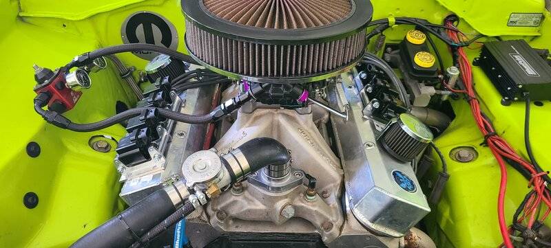

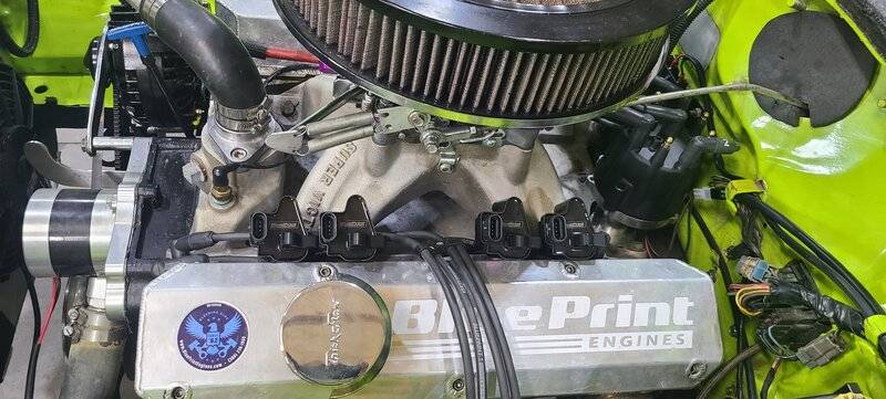

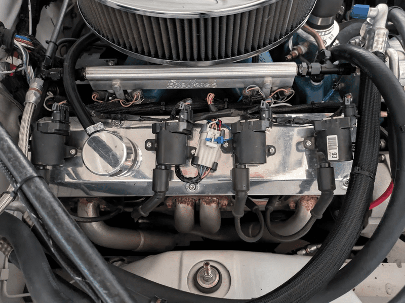

Mine are mounted on the aluminum valve covers cant take all the credit Mad dart originally did them and I modified for the different LS coils.

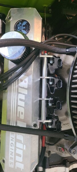

Here's what I used to mount mine. I drilled 4 blind holes and tapped them to an aluminum plate that I welded to my valve covers.

If you use the Jeep cam sensor, it will free up a bunch of room where the distributor is. I made brackets as mentioned above to hold the LS coils with the heat sinks on them. I guess you need to decide if you want them somewhere that looks good or somewhere that makes easy access to them or for valve cover removal. Mine looked good and allowed for easy valve cover removal, but they were hard to access if one ever failed.

Top does look good, just drill and tap and red lock tight the bolts in and call it good. Buy some LS spark plug wires and good to go.
I welded some cheap D585 coil brackets to the top of my VC. The downside to that is if I ever wanted to switch to IGN1A coils, I'd have to buy new valve covers. I think if I were to do it again I'd weld 2 or 3 blind hole bungs in the VC and make an adapter plate for any coils I wanted to run.

That said, I understand the servicability and don't mind them on the VC's. The only one I don't really care for is remote mounting them off the motor. Just an aesthetics thing for me.

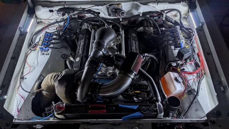

I think @goldduster318 did a CNP setup as well?

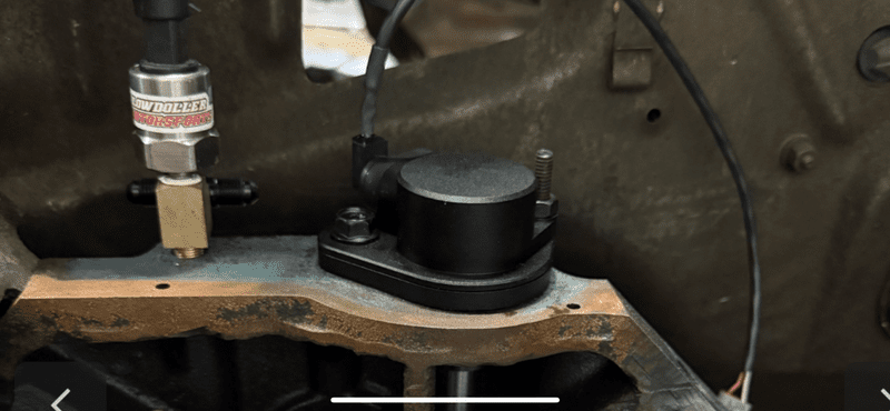

Also I should mention I have a 36-1 wheel on the crank pulley and a 92+ Magnum distributor with the rotor part cut off for a cam sensor. No need to get too fancy on the cam sensor at all. I would have made a better crank sensor bracket if there was ever a problem but so far there hasn't been.
