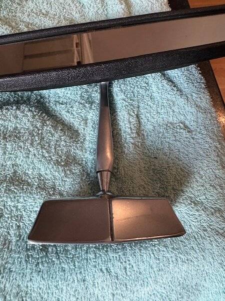

I already bought davescuda's mirror (pics posted above). At minimum, we'd disassemble the mirror and use the mount to engage the visors. That said, we are also considering loosing the visors too. I'm traveling until late in the week and will deal with this stuff when I get back from the trip and have the mirror from davescuda. Guess I'l spend some time looking for aftermarket glass attachable mirrors in the meantime so we have a contingency plan.

Good idea on removing the mirror just to hold down the visors. I've also considered shortening the arm that the mirror is attached to by cutting it down, drilling it, and using a long set screw to reattach the ends.

Well the mirror end will not go through the hole :(
But it got me to thinking....
I could reverse engineer the shaft but shorter.
And either reuse the ball end buy having a setscrew in the shaft to capture it in a hole or RE the ball end and have threads.
And print it in Stainless steel
My guess is the ball end is pressed into the cast end ( or the cast part is cast around the ball end )

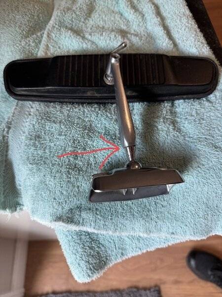

So the stem pressed into a headlight switch knobs is barbed for obvious reason. I'm wondering about the ball stud,,, splined? Barbed? Might learn something here. LOL
Where the arrow is the ball end is splined and pressed into the shaft. You would have to separate it here and then you can use a shorter shaft. Also you can change the ball part also and get a shorter splined area, The round shafts are a lot shorter
