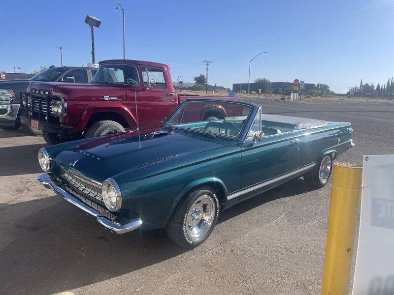

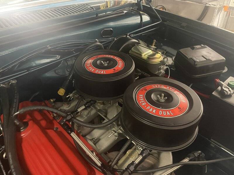

well Im gonna try that theory. I had the head on mine machined for the larger valves along with a polish and port. It cant hurt. I used teh SI 1.7/1.44 valves. My engine has been run but not yet driven.
