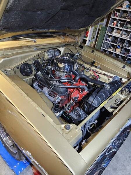

B motor 69 Dart needing upper rad hose. Here is a picture of the set up. Stock water pump with aftermarket rad driver side . For reference the rad hook up it inline on the middle of the drivers valve cover . Anybody got a part number to guide me the way ?
It's almost in the same location. Hose is for a '70 340 T/A.
It’s very close for sure . Thanks I’ll look into it !!

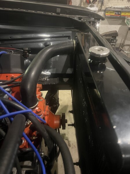

Found and installed thanks all !!
I ended up going with a 1970 Challenger with 383 22 inch rad ( 60662 ) seems just about perfect - one step closer !!
