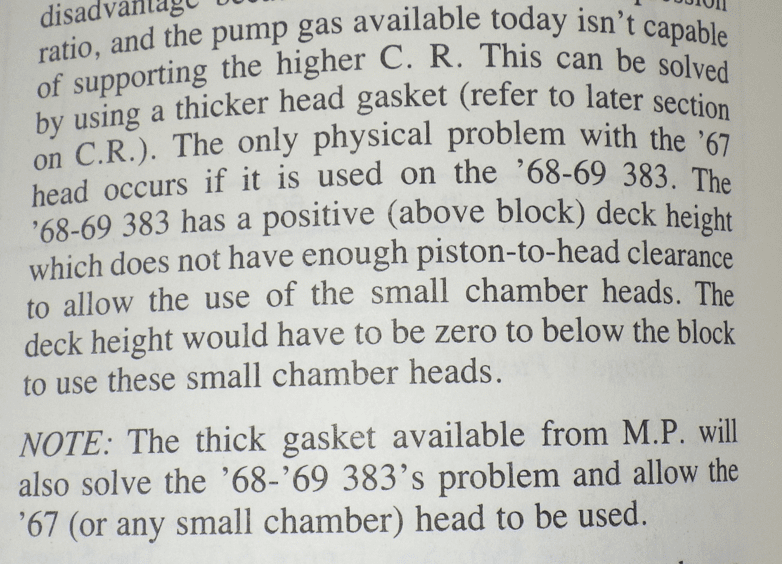

FWIW, and few will remember, the outlier one had to be aware of. That's the '68-'69 RR 383 with the + deck. I couldn't put 915s with steel shim gaskets on my '68 way back so I had a valve job done on the 906s.
Not sure what problem you had, but the only 383 block that was a tall deck was in 1959 or so. 915s go just fine on any 383 block given the correct intake.
Hence I say "few will remember".
Did your 383 actually have pistons above the deck? I've had several 68-69's that all came up short of even being at zero deck.

Did your 383 actually have pistons above the deck?...........
FWIW, I traded in my '66 Sport Fury (also a 383) for the '68 RR in '75. What I recall, when I pulled the heads and scraped the deck by hand out in Dad's driveway, I could hang up the scraper on piston tops and had to rotate the crank to clear them. I can't tell you actual dimensions. However, it's something you don't forget when it's your first time doing it.
I don't know if the engine had been modified prior to my ownership. I doubt it was.
BTW, I also recall that engine being painted orange, not turquoise. That in itself tends to raise the eyebrows.

"......scraped the deck by hand out in Dad's driveway,....."
These are the stories I love.
One thing I've learned about Chrysler products over the years is to never say never.......
True enough. It wouldn't surprise me one bit if some of the pistons were above on one end of the bank, and below on the other.
They went to a taller compression height to compensate for the 906 open chamber heads. Thats why when you put 67 heads on a 68/69 motor you raise your compression almost a point. Forget NHRA specs. Thats the maximum allowable for stock competition.
