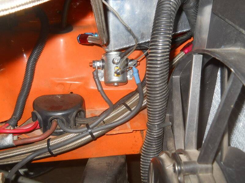

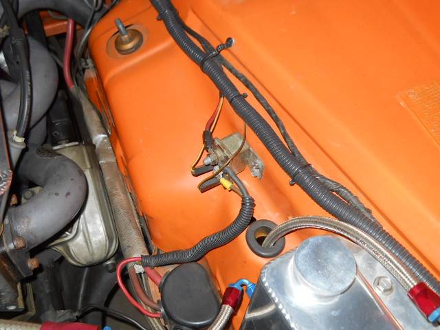

I put a battery post junction on the front rail. Ran the cable from the trunk to it and used it as my Pos. battery terminal like it is the battery. Ran my original battery cable from the starter to the terminal installed.
